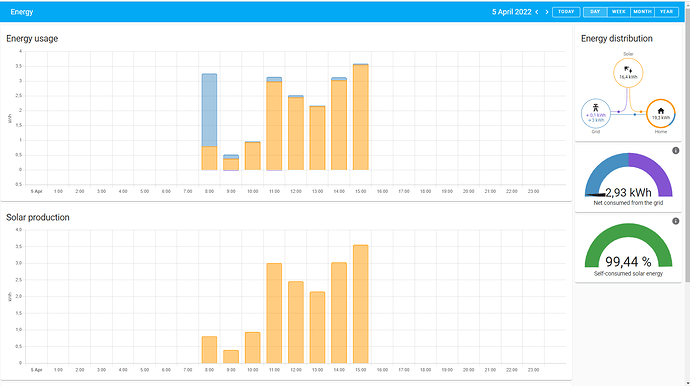

im just used to working off Power instead of energy, its just a number but in the fronius app shows this
its just understanding it better
The HA energy page is showing energy data, summed for each hour. That Fronius app screenshot is a snapshot of live power data. They are different things.
The HA energy page is showing in the lower pane the solar PV output by hour, while the top panel shows where that energy went - some of it self-consumed (orange), the balance exported to the grid (purple).
The HA Energy page animated graphic on the right with the moving dots is a bit confusing as it is showing energy totals, while the animated graphics give the impression it is power data like the Fronius app is showing.
