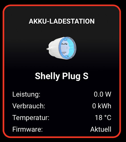

The with state_Display can not work in my opinion, because as sensor_4 the value on or off is output.
My question was whether I can display the German designation Aktuell or Verfügbar instead of on or off.

sure it can, thats the whole idea of state_display, and why I asked Romrider to introduce it in the frist place …
did you try the template in that linked issue?
show_state: true
state_display: >
  [[[ return (entity.state === 'on') ? 'Verfügbar' : 'Aktuell'; ]]]
Yes, I tried but could not get it to work.
The one who designed the template for this button card worked with variables, but state_Display refers to the entity_id or do I understand it wrong?
Thanks for your patience

Thanks to your help I got it done, thanks for your support.

  sensor_4: >
    [[[ return states['update.' + variables.var_sensor_name +
    '_firmware_update'].state === 'off' ? 'Aktuell' : 'Verfügbar'; ]]]
I’ve cleaned that up a bit for you, and gave the fields more descriptive names, shortened them, and, important, added javascript delimiters on all of the templates.
since you still hardcode the double-tap entity, I take it you dont have a naming convention on all of them? otherwise this would be a very nice spot to also use the variable construction.
variables:
  double_tap_entity: >
    [[[ return 'sensor.' + variables.id + '_power'; ]]]
that way you can move all of this inside a template ‘shelly_plug’ and in the dashboard only use the 1 single config like

but you can make it even simpler by doing away with those label variables, and simply put that inside the actual variable. like is done in eg this cpu button. They are just plain strings (and not variable…) so can be used like:
