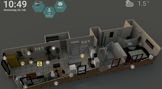

Im working on my floorplan dashboard at the moment.
For additional person cards i want to use custom:button-card in a hexagon style.
Grid_Button-Card_Person
I want to set the round entity picture in the middle of the upper half.
On the lower half i want to set the name and the state of my person entity.
But as u see it didnt get to work.
Heres my code:
          - square: true
            type: grid
            card_mod:
              style: |
                :host {
                  position: absolute;
                  left: 21%;
                  top: 7%;
                  opacity: 0.7;
                  mix-blend-mode: normal;
            cards:
              - type: custom:button-card
                card_mod:
                  style: |
                    :host {
                      aspect-ratio: 1/cos(30deg);
                      clip-path: polygon(50% -50%,100% 50%,50% 150%,0 50%);
                      background: #3B8686;
                entity: person.micha
                aspect_ratio: 2/1
                show_entity_picture: false
                state:
                  - value: home
                    styles:
                      custom_fields:
                        icon:
                          - border-color: '#77c66e'
                  - value: not_home
                    styles:
                      custom_fields:
                        icon:
                          - border-color: deepskyblue
                  - value: Dossmann
                    styles:
                      custom_fields:
                        icon:
                          - border-color: '#B83838'
                styles:
                  grid:
                    - grid-template-areas: >-
                        "icon"
                        "name"
                        "state"
                    - grid-template-columns: 1fr
                    - grid-template-rows: 1fr
                  custom_fields:
                    icon:
                      - clip-path: circle()
                      - width: 50%
                      - pointer-events: none
                      - display: grid
                      - border: 3px solid
                      - border-color: '#808080'
                      - border-radius: 500px
                      - margin: 0 0 0 0
                      - opacity: 1
                      - align-self: start
                      - justify-self: end
                    name:
                      - align-self: end
                      - justify-self: end
                      - background: none
                      - padding: 5px
                    state:
                      - align-self: start
                      - justify-self: middle
                      - background: none
                      - padding: 5px
                      - margin-top: 5px
                custom_fields:
                  icon: >
                    [[[ return entity === undefined ? null : `<img
                    src="${states[entity.entity_id].attributes.entity_picture}"
                    width="100%">`; ]]]
                  name:
                    card:
                      styles:
                        card:
                          - color: var(--contrast20)
                          - font-size: 14px
                          - font-weight: 600
                          - background: none
                  state:
                    card:
                      show_icon: false
                          return states['person.micha'].state;
                      state:
                        - value: home
                        - value: not_home
                      styles:
                        card:
                          - font-size: 13px
                          - background: none
                          - opacity: '0.7'
                entity: person.isa
                show_state: true
                card_mod:
                  style: |
                    :host {
                      top: 45%;
                      left: -32%;
                      border: #434589;
                entity: input_boolean.hund_daheim
                styles:
                  entity_picture:
                    - size: 20%
                entity_picture: /local/willow.jpg
                card_mod:
                  style: |
                    :host {
                      left: -63%;
            columns: 3
I only use a grid, because i didnt know how i can set a absolute position for a custom-button card. :sweat_smile:
Maybe someone could help me? :slight_smile:

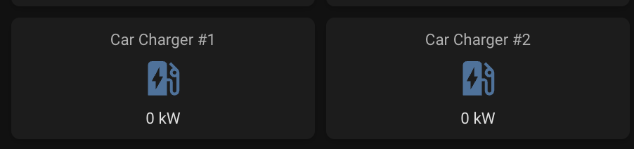

I’m trying to pull some latency values from sensors in The Unifi integration into a custom-button-card. The value, in milliseconds, will show up correct in a stadard entities card, however in the custom-card it shows as seconds. See screenshots and code bellow.
How do I format or template the value to show up correct, in ms in the custom-button-card?
From the custom-button-card:
From the stock entity card:
My code:
entity: sensor.hytta_hh_cloudflare_wan_latency
show_icon: true
show_name: true
show_state: true
styles:
  card:
    - background: var(--card-background-color)
    - height: 70px
    - border-radius: 20px
    - padding: 0px
  name:
    - position: absolute
    - bottom: 45%
    - left: 40%
    - font-size: 15px

I am looking to improve UX for my car charger toggles. I have a button, that toggles my car charger.
entity: switch.car_charger_1_charge_control
styles:
  name:
    - font-size: .8rem
    - opacity: 0.75
  label:
    - font-size: .8rem
    - white-space: nowrap
  icon:
    - height: 75%
  grid:
    - grid-template-areas: "\"n\" \"i\" \"l\" \"s\""
triggers_update: switch.car_charger_1_charge_control
name: "Car Charger #1"
label: |
    return `${states['sensor.car_charger_1_power_active_import'].state} kW`;
show_label: true
hold_action:
  action: more-info
card_mod:
  style: |
    ha-card {
      height: 100%
When pressing it, it takes 3-10 seconds for the charger to turn on. Sometimes it’s not clear whether I successfully tapped the button or accidentally dragged my finger so the tap didn’t happen.
I would like to disable the button and apply some CSS to make it very clear that the button press happened. How can I change CSS in tap_action? In Javascript I’d do something like:
