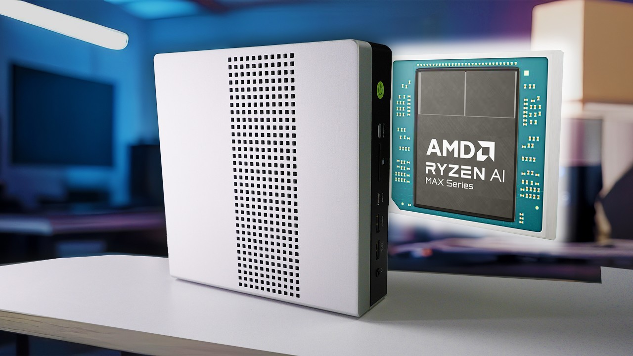

The new AMD CPU with NPU, I think there is only one model out right now, with its RAM partitioning sounds promising also. Not cheap but uses regular DDR5 RAM so 2K with 128GB of RAM with supposedly 256GB/s memory bandwidth. It’s like apples unified memory but you have to specify how much RAM you want dedicated to the CPU and GPU. Nvidia makes a GPU with 96GB of VRAM but it’s 10K. Probably not near as fast but allows you to run 70 billion parameter models granted it’s 5 tokens per second but for something like lama3.2 it’s around 250 tokens per second. Regardless way cheaper than VRAM even if it’s not as fast but I have a feeling some of these new Nvidia Jetson models are going to be extremely expensive. I hope to be proven wrong but it’s Nvidia so… That and the AMD can be both a daily driver PC and AI machine for HA once you get the memory partitions so it performs both. At least with the Jetson lineup, it’s not going to be a daily driver outside web browsing. That and the technology will only get better. Then again something else may come along. My only requirement is 100% local and price which does need to come down.

I bought my Strix Halo last year and it allows me to run gpt-oss-120b.
I also build my own assistant, speech interface with Whisper and output with ZipVoices cloned voices. Whisper Large runs little under 100% real world speed and ZipVoice maybe 70-80% in Strix Halo. Have build a couple of assistants, and HA assistant connects to HA MCP Server and a couple others. I’ve only exposed a small set of sensors/devices.
Good thing with gpt-oss-120b is you can ask questions like ‘what is the average electricity price tomorrow between 12 - 16’ and it knows how to get that from json data and calculate average.
Normal commands like “turn on living room reading light” takes about 6-7s.
Bigger model is needed because commands are given in Finnish, gpt-oss-120b thinks and HA devices are in English and the results are then translated back to Finnish. Just tested qwen3 next 80B. It was ok too, but in benchmarks gpt-oss-120b seems to be a winner.
Strix Halo is not the fastest but it’s idle is about 20w so it’s more reasonable to be always-on, and it has also other use.
