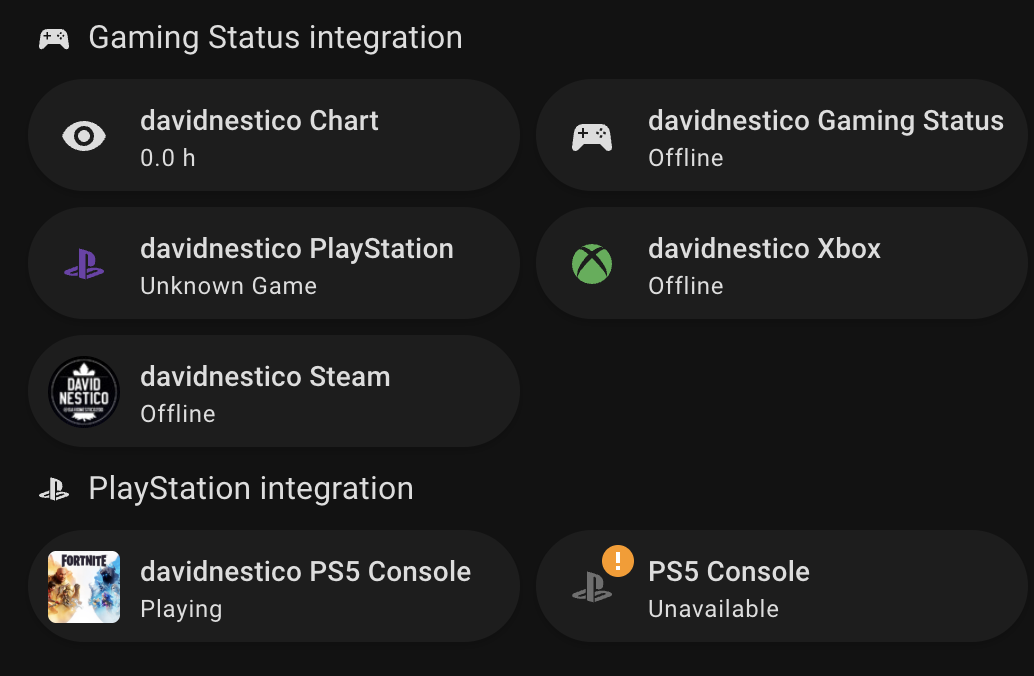

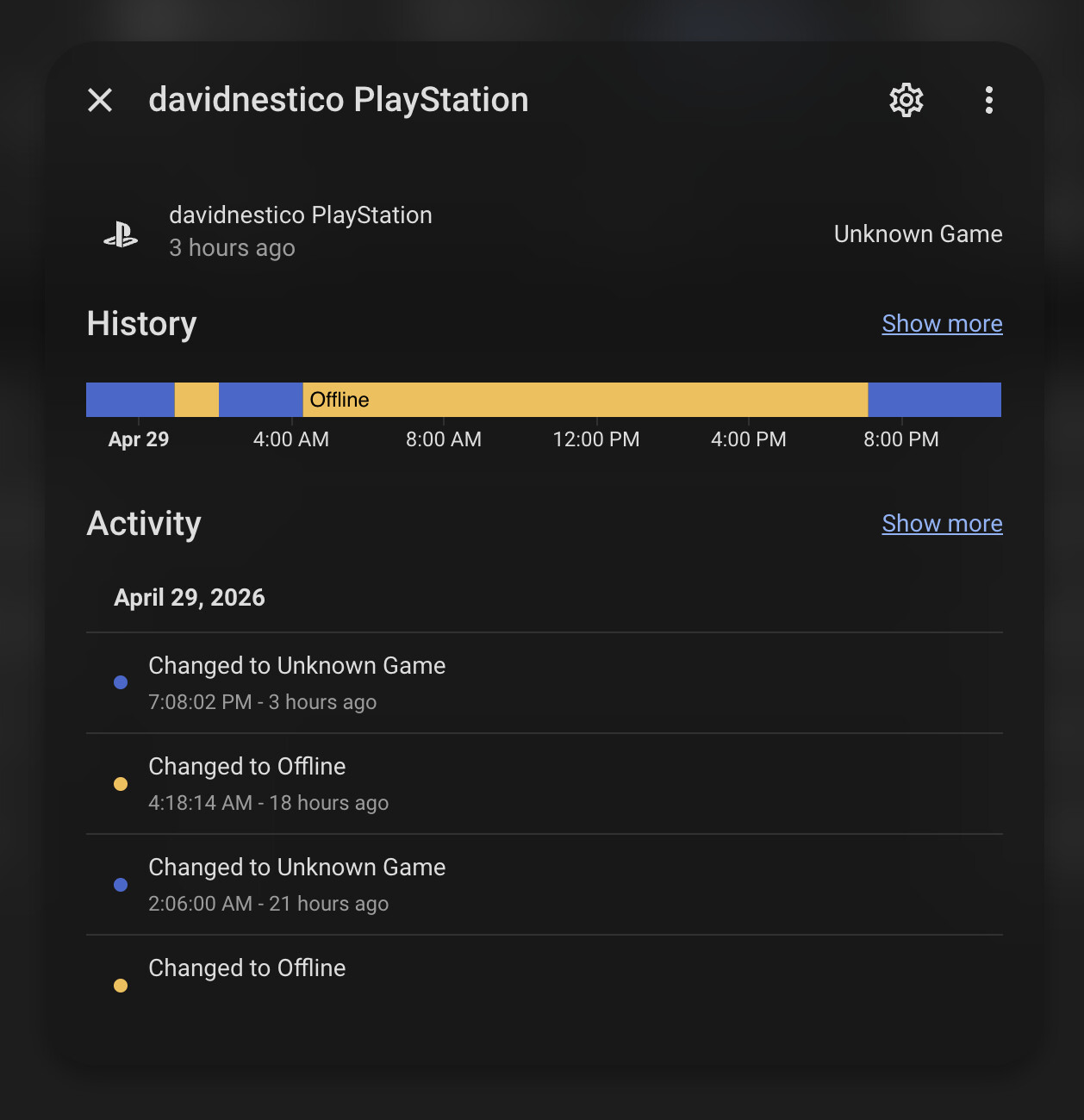

Not sure what’s wrong tbh it seems to be half working, I’m playing fortnite on PS5 right now and the PS5 integration knows its Fortnite but yours says unknown game for whatever reason, not just fortnite it did it with every game I played NHL 26 and AC Shadows as well and same thing, so no tiem isn’t tracking cuz of that rn.
And you have the official PlayStation integration installed and working, correct? Does that integration properly report your in game status in the davidnestico_now_playing sensor?
I will test it again on my PS5 shortly to make sure I didn’t break anything with any recent updates.
PS5 is still working fine for me, so I’m not sure yet what is causing yours to not properly display your game status.

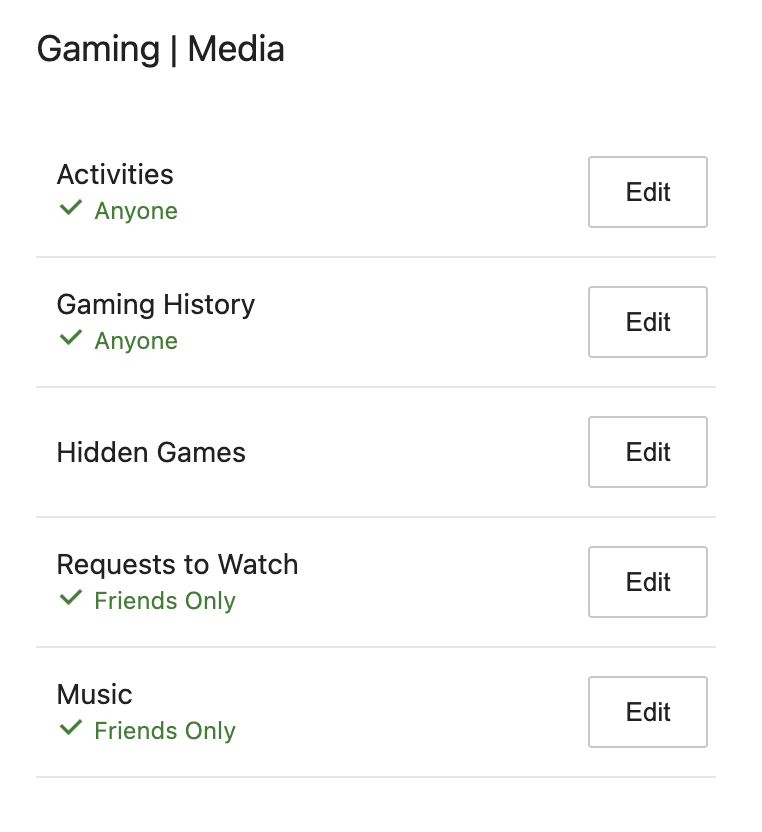

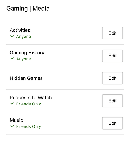

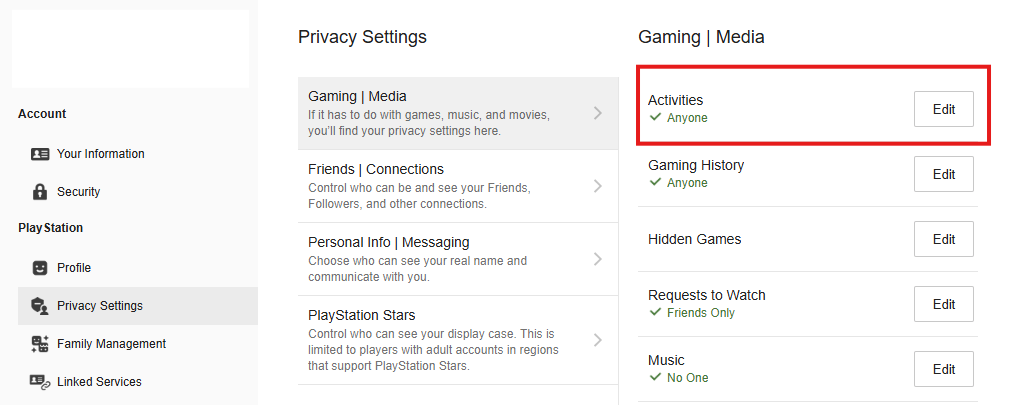

You may need to check your PSN privacy settings though, using the steps below (on your PS5, or similarly through the PlayStation web site):
  • Settings > Users and Accounts > Privacy > View and Customize Your Privacy Settings.
  • Find the setting: “Who can see your online status and what you’re currently playing.”
  • You need to change this to Anyone
  • On the web, it’s located as shown below

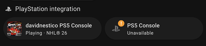

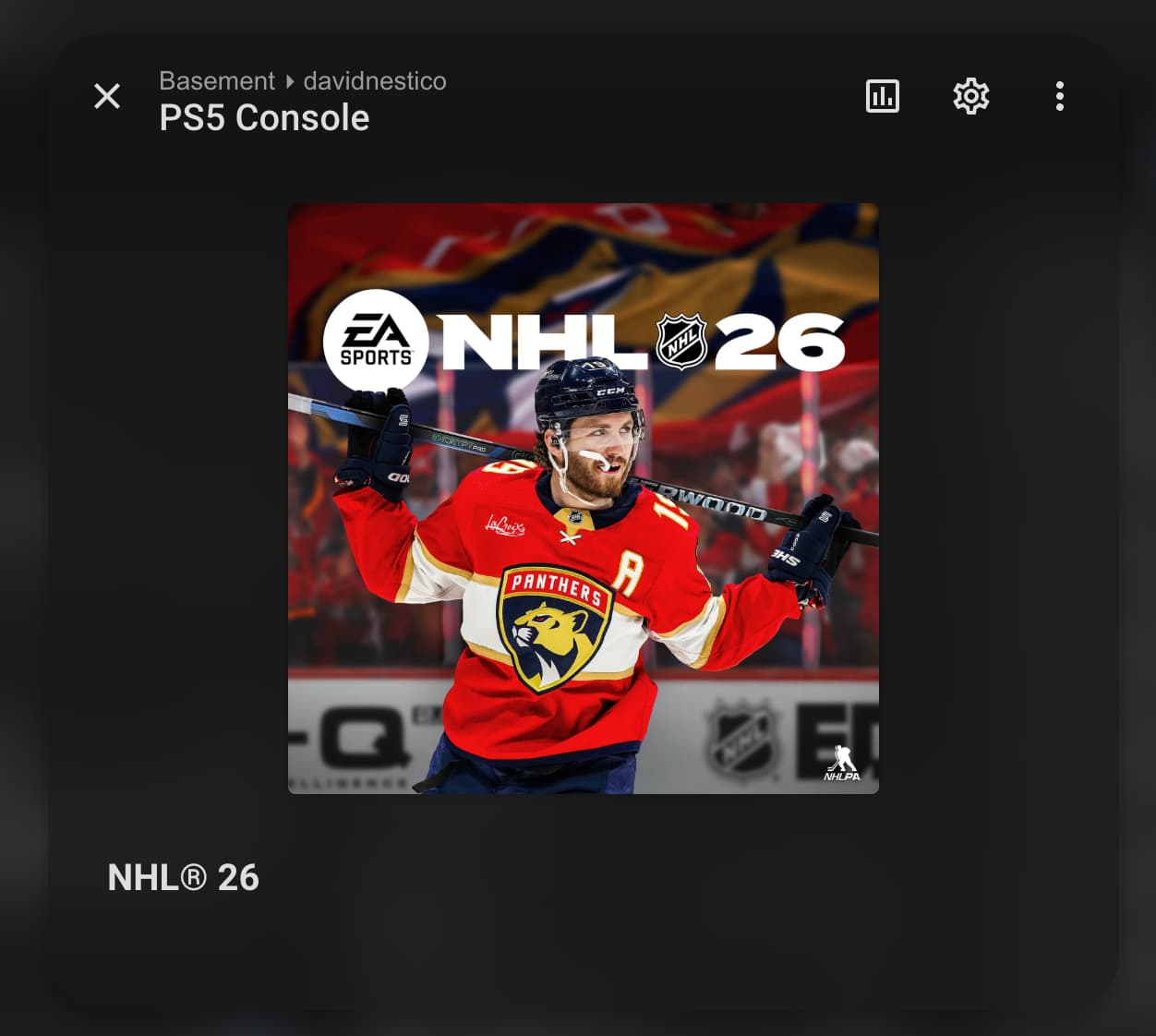

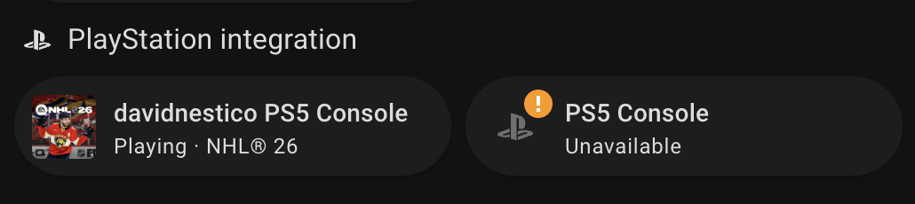

There is no “now playing” sensor for the PS integration, there’s a status integration that says “playing”. There’s a PS5 media player that says I’m playing NHL 26 right now also.
I’ve already set that up because the regular PS integration works fine for me.
Also a status integration that says NHL 26 in the attribiutes

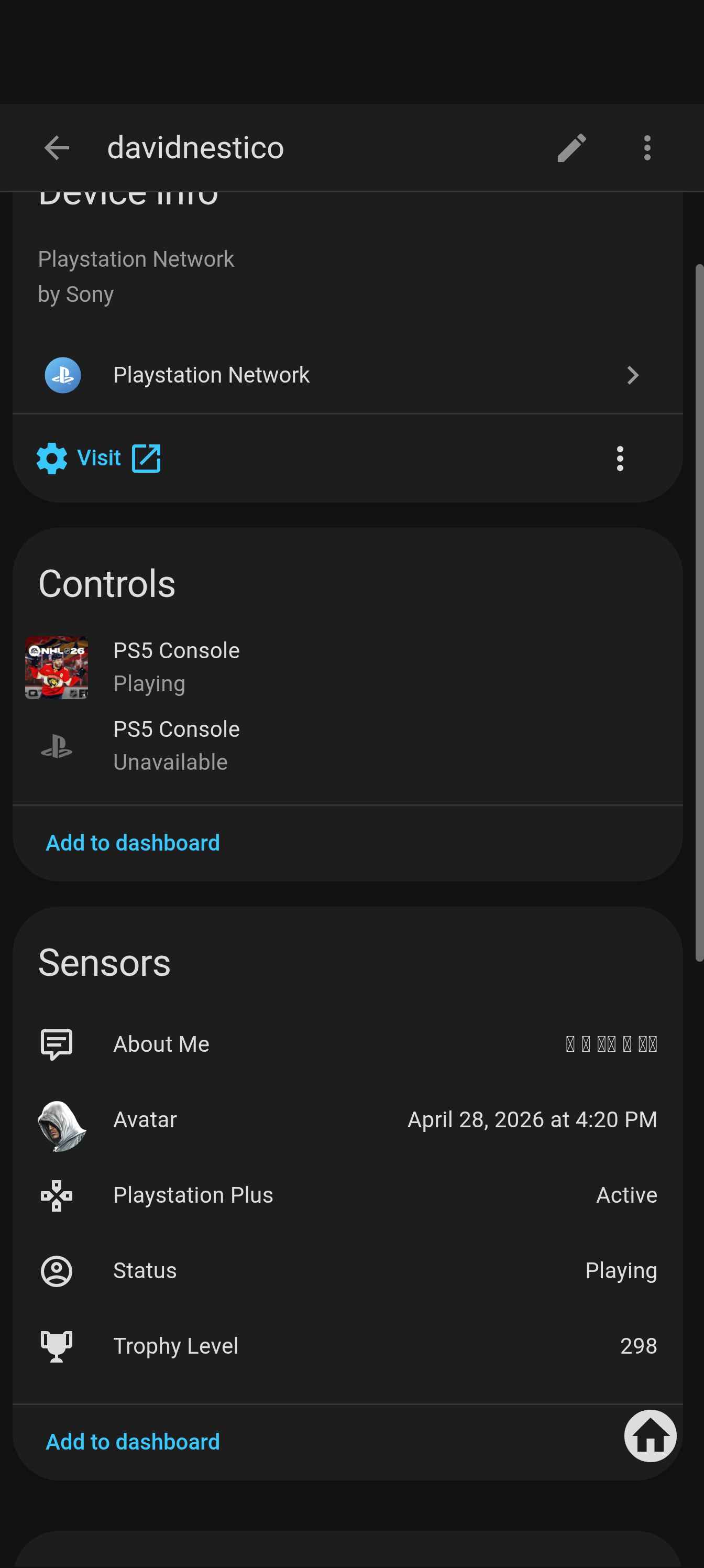

Your integration
So, under Settings > Developer Tools, there are no PlayStation sensors ending in “_now_playing”? Im assuming we’re using the same PlayStation Network integration, since there’s only one that I know of, and all of the accounts I have added provide a “_now_playing” sensor.
When I view my account in the PlayStation Network integration, I have 23 different entities that it creates, including a “Now Playing” status and image, which are necessary for the Gaming Status integration to function properly. If your sensors are somehow missing or named something different, I can try expanding the code to account for other naming conventions.
This is the one I’m using, he moved it to a HA integration but I never migrated cuz I think the HACs version has more features then the integration as of rn but could be wrong.
I don’t have that many sensors
Ah, ok. I have no experience with that one, but it doesn’t look like it reports the game being played from your screenshot. If you want to try the official PlayStation Network integration, it SHOULD work for you. It’s pretty robust now. The only downside is having to re-authenticate it every 60 days.
