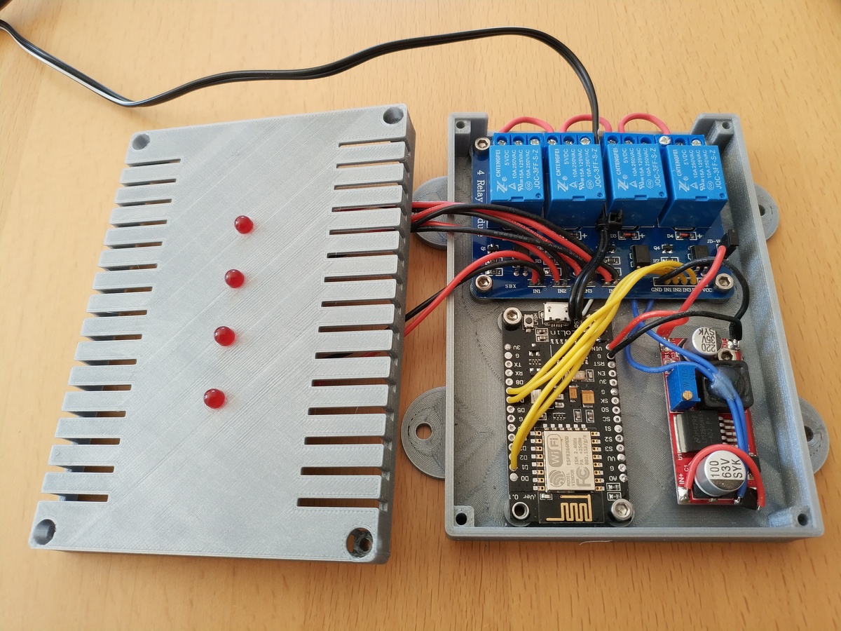

wanted to share my finished irrigation controller hardware. it’s really simple, and one of the most straight forward wirings ever.
just 4 digital i/o to connect.
it’s powered by a dc/dc 5V 3A converter. as the power supply for the valves is 24VAC (corrected, was 48V before) there is a small recitifer to modify AC to DC at the step down converter. that way i can power the valves and the nodemcu AND the power hungry relais with one power supply.
if anyone is interested i can share the .stl and aliexpress parts list. it’s just a few euros/dollars.
enjoy

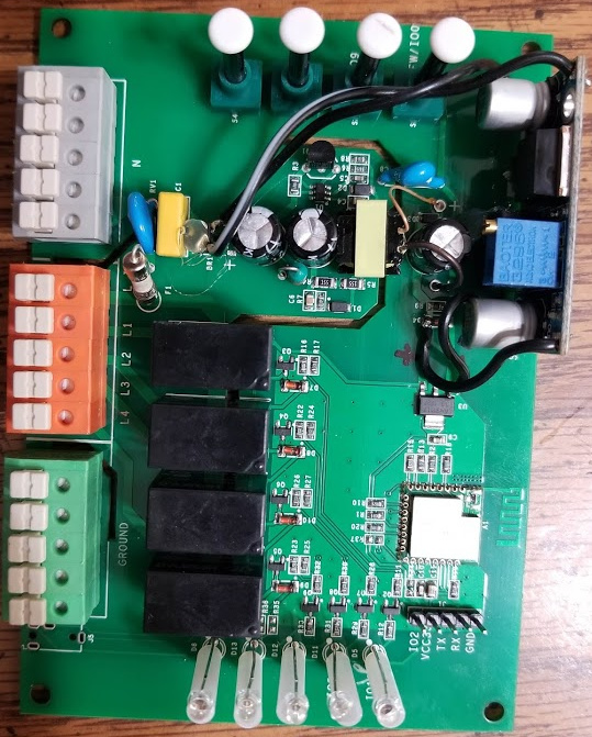

Just for a reference point, I integrated a DC-DC converter (https://goo.gl/ucBcag) onto a 4-channel (non-pro, non-R2) so that it would run on a standard US 24VAC irrigation transformer. The module is a 40V input 2A output adjustable supply. I attached it to the bridge rectifier on the 4CH and back to the 5V rails. The input voltage tolerance is a little tight if you account for over-voltage conditions on the supply, so make sure your input is between 10 and 30VAC. The same can be done with a Sonoff Basic. I just hot-glued the DC-DC on.
