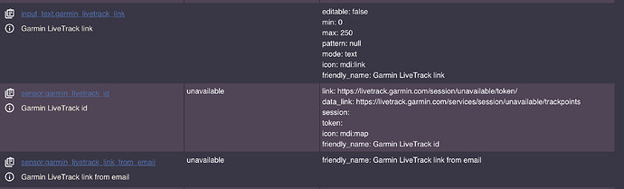

I tried to add the package but somehow I have various sensors ā€žunavailableā€œ or ā€žoffā€œ. I set up the Imap-integration as well and that works so far.
Any help would be much appreciated. Enclosed two screenshots of the not working sensors in developer tools.
Edit: forgot to fetch the first 9200 bytes from the mail… now itā€˜s working
