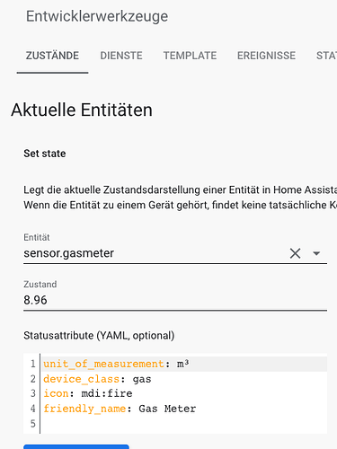

I configured the “Gasmeter” linke above. I Can´t configure the energy the gas consumption (in the right screenshot).
Or is there a mistake in the configuration?
you missed to create the counter under configuration–>Automations&Scenes–>Helpers. If it’s done, you need to add this entity to your automation.
Thanks, @balagev79
I added the counter, but I can´t see any entity in the line “Gasverbrauch (ft, m, Wh,…)”.
It´s also counting…
you are missing the attributes, since the 2021.12 you have to add them to customization.yaml manually, no interface anymore.
customization.yaml
sensor.gas_meter:
  state_class: measurement
  last_reset: '2021-08-20T06:43:36.740703+00:00'
the sensor needs to look like this to be selectable in Energy under Gas.
as @mpetcu mentioned, you need to put these attributes into customize.yaml…and restart HA!
Thanks! I did so. The mistake: the customize.yaml has to be uncluded :confounded:
