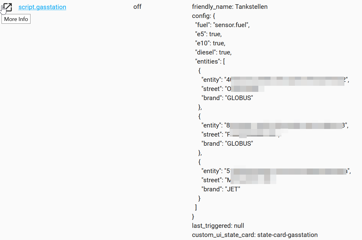

I have used your instructions from https://www.panbachi.de/tankerkoenig-preise-in-homeassistant-darstellen-141/
to create a state card for selected gas prices.
My card is empty and did not show any gas station.
I have checked my config files with hass --script check_config and have detected no errors.
What’s wrong here? What can I do to locate the error? Any hints?
Thank you.
regards Tom

How does your config in the sensors.yaml look like?
