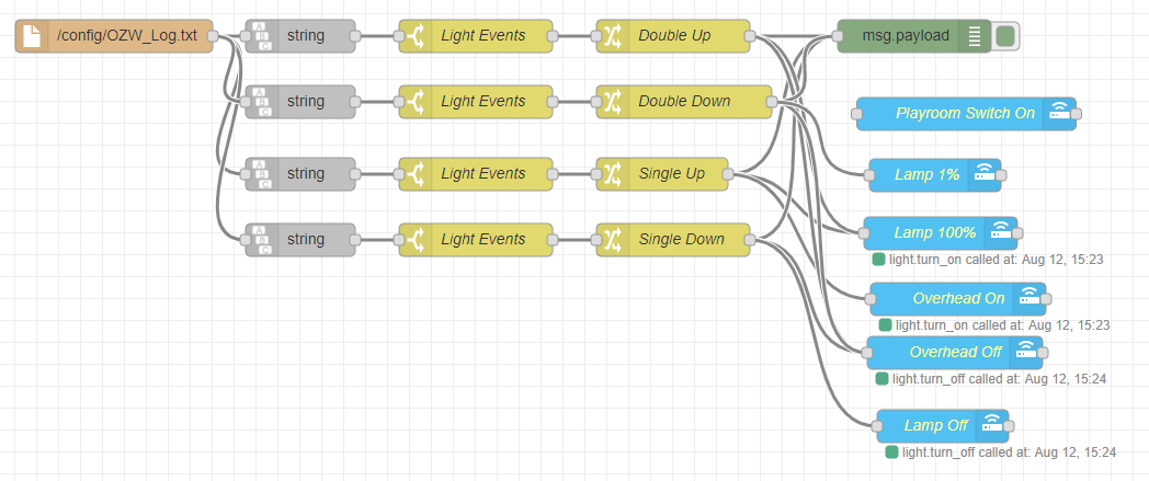

Is there anyway to parse this line from owz “Node004, Received SwitchBinary report from node 4: level=Off” so that I can create automations for single and double tap events? I have doubletap automations working but I would like to control things with single tap too, specifically when single tap up is pressed if the switch is already “on”.

I had the same question as you and ended up doing this by tailing the OZW_Log file then looking for both the double tap commands and the single tap commands.
Example Double Tap
Node010, Received Basic set from node 10: level=255
Example Single Tap
Node010, Received SwitchBinary report from node 10: level=On
I think that the “SwitchBinary” command does not show up on the event log in HA, which is why you need to tail the OZW_Log file.
It seems a bit hack-y but it actually works well, the lights respond pretty quickly and I haven’t seen too many hickups.
