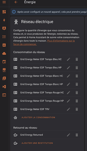

In my case, I don’t have anything connected to the Linky: I only have a Shelly EM reading imported and exported energy.
So to couple the prices with the RTE Tempo integration from @hekmon, I have created a bunch of entries:
First one input number for each combination of Color and HP / HC.
Then I have created a utility meter with 6 tariffs + TRV (this will auto-create 7 utility meters with a selector)
I can then create these cards to set prices and select the current utility meter where the read energy data will go:
But now, the magic is that thanks to the RTE Temp plugin, I can have a script and an automation that will automatically switch the right utility meter to use:

Device ID 9c2a0444638b52b827cc51a274c5d1f9 is actually the RTE Tempo device created by the RTE Tempo integration.
Then in the Energy Dashboard, we need to add all the utility meters, and for each one, link it with the corresponding price entity
