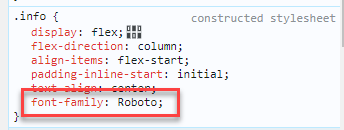

I was trying to use the Global Mod to change the font-family for the new badges.
The example with yellow sidebar is working for me.
Could you please help me with path and selector for the .info class of the badges?
Actually I was able to do it finally, however it is working only to the first badge, and not the rest.
Anything can be done to make it work for all?
  badges-path: '/'
  badges-selector: 'home-assistant-main$ha-panel-lovelace$hui-root$hui-sections-view$hui-view-badges$hui-entity-badge$ha-badge$div span'
  badges-style: |
    .info {
      font-family: inherit !important;
The below approach actually works, but have to provide selector for each badge separately, not something global. Which is not that convenient.

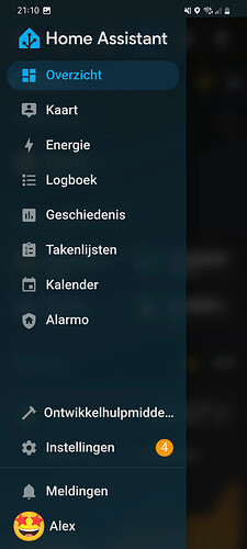

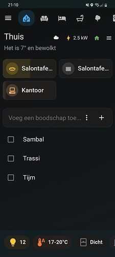

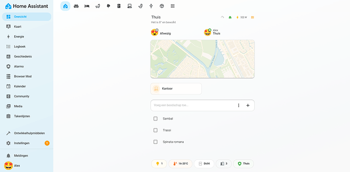

With the 0.3.0 release last week, I’ve made some major performance improvements. First up, this is currently my theme / mod:
I’ve completely styled the sidebar, header, background and many small elements. I’ve based my design on Material Design and is injected into the default theme. Which means I have a functioning primary and accent color selector:
f8txjTbuQJ9vuAUjOtBbfGlf
I also utilize transparency and CSS effects. And of course I use the same mods on mobile:
But like I mentioned, performance has improved massively:
