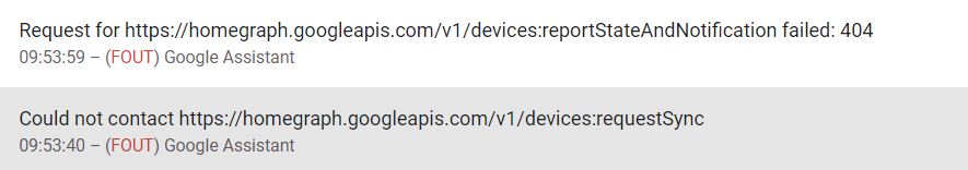

The warning is gone, but today i got 2 new ones
Does it relate?
Anyone now where to look for to fix?
calisro
(Rob)
June 19, 2022, 2:20pm
301
No. and those happen quite a bit. The google api…

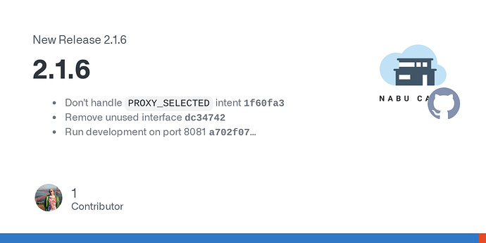

Davidy
June 21, 2022, 8:52pm
302
I updated to 2.1.6 last week and have had no issues with Local Fulfillment since then.
