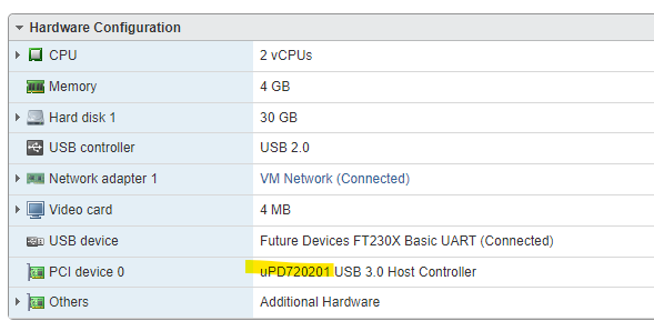

@Kingy444 My ESXI version is VMware ESXi, 7.0.3, 20036589. Have you enabled passthrough for your usb host controllers to the Virtual Machine ? If you have any other USB devices plugged into this esxi host then it will get picked up by your Virtual Machine.
This is a picture of my virtual machine with the USB controllers attached.

Hi Reesion,
My Coral is connected to a ubuntu vm running in esxi which i flash the coral usb.
This ubuntu vm then runs frigate.
I disabled vmkusb and then i passed through the usb controller like the picture in my previous comment.
This effectively passes all the usb devices on that host to that linux machine.
Just note this will pass through any other usb’s you have connected to this virtual machine.
Hope this helps
