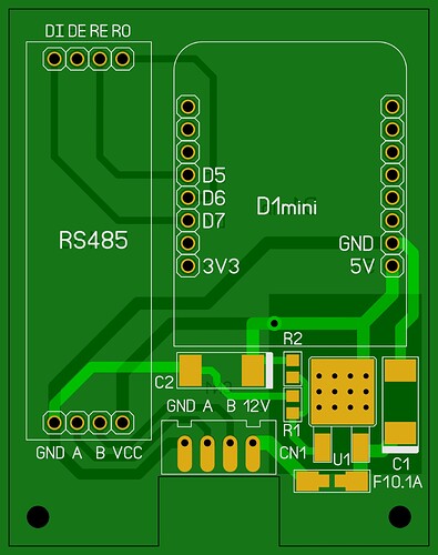

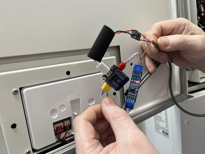

Hello, those who have esp or wemos connected, how did you solve the power supply? Using external brick or connected directly to heat pump mainboard ? Please share your ideas, in my case it’s hard to connect external power supply.

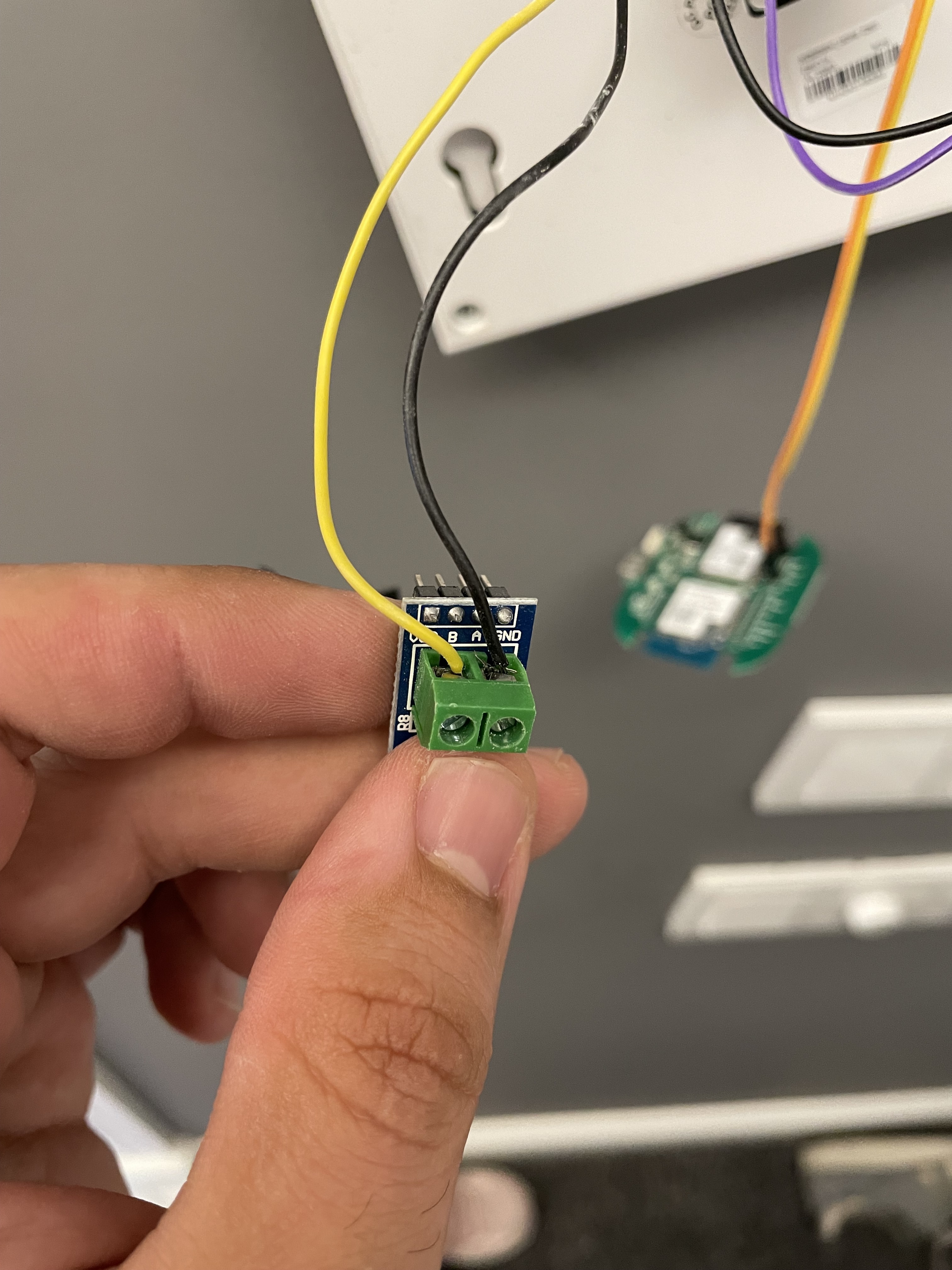

I have moved this display to another spot in the house so I can control the temp without going to the boiling room.
I have a 2 questions:
  1. Since this display has only one modbus port, did you connect in parallel or did you use some other ports on the board? I believe it has another one with 2 pins?
  2. Can you set temperature via Homeassistant like you can do it via display?

could you please attach picture how did you connect the display of the HP and RS485?
Thanks
Display uses port 2, modbus is 1.

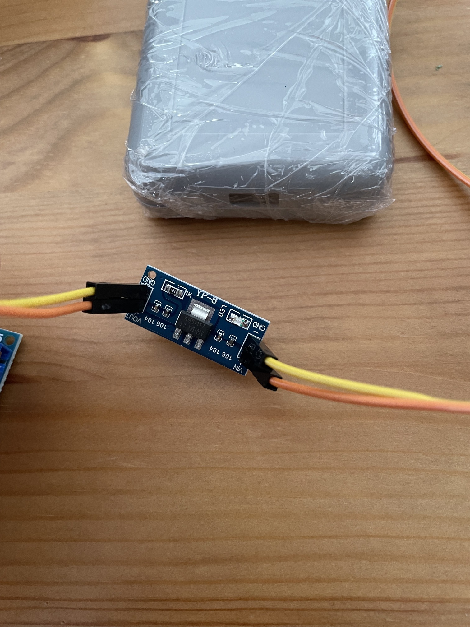

The control unit has a 12V DC out. I have used a step down from 12V to 5V to power my ESP8266.

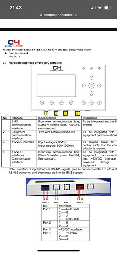

Can’t find it, could you mark on electric wiring diagram of Versati III ? Or a photo of the board. Or by “control unit” you meant a LCD display unit? :slight_smile: Much appreciated.
Of course, here you go. My model is Versati II
Thanks, Versati III doesn’t have separate +12VDC, but i can use power from panel.

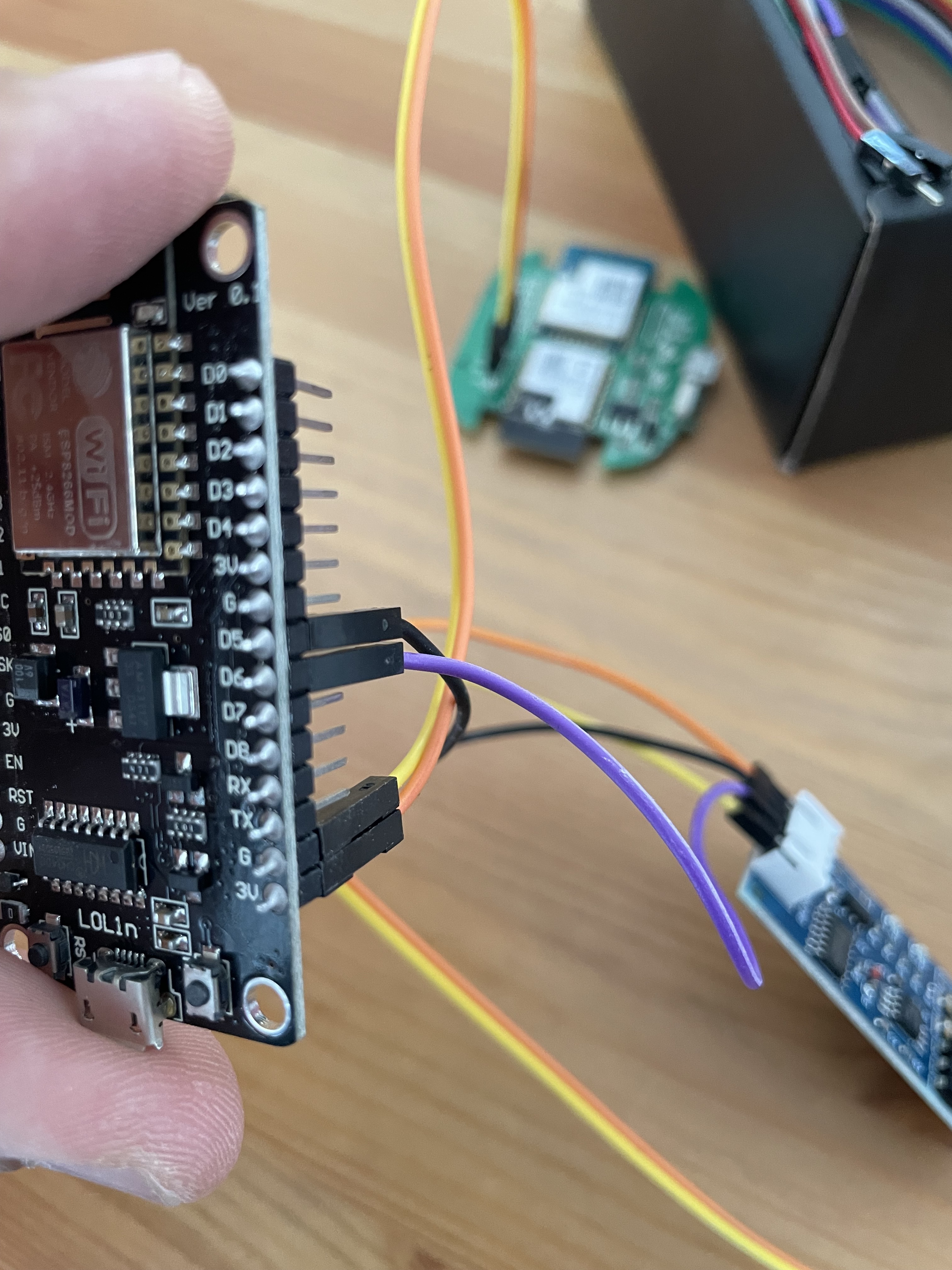

Anyway, what do you have connected to your LOLIN in the 3rd and 4th picture?
I see TTL to RS485 converter and what is the other thing?
Oh, that is a different matter unrelated to the ESPHome project. It just receives 3V from the board. Apologies for the confusion.
My ESPHome setup is 12V from control panel with 12V to 5V step down, GPIO pins toTTL to RS485 connected to the BMS port.

My prototype.
Ordered some boards , planning to put everything in single place.

ah I missed the second connector :smiley: thank you a lot

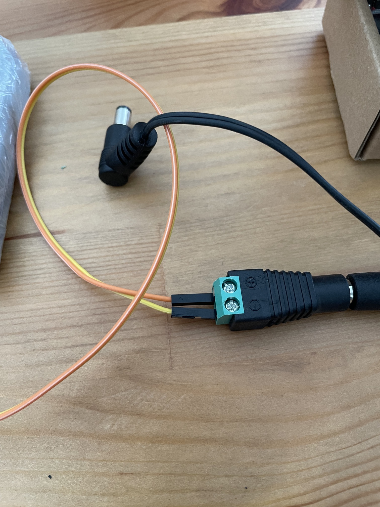

Can you please tell me one more thing, I am struggling to find the right connector for the AB port, I see that you have posted the pictures of your prototype and I saw the connector?
No idea what’s the name, found one in the “random stuff” box, but as far as I remember, it was bought in a local electronics shop, it’s not something rare.
