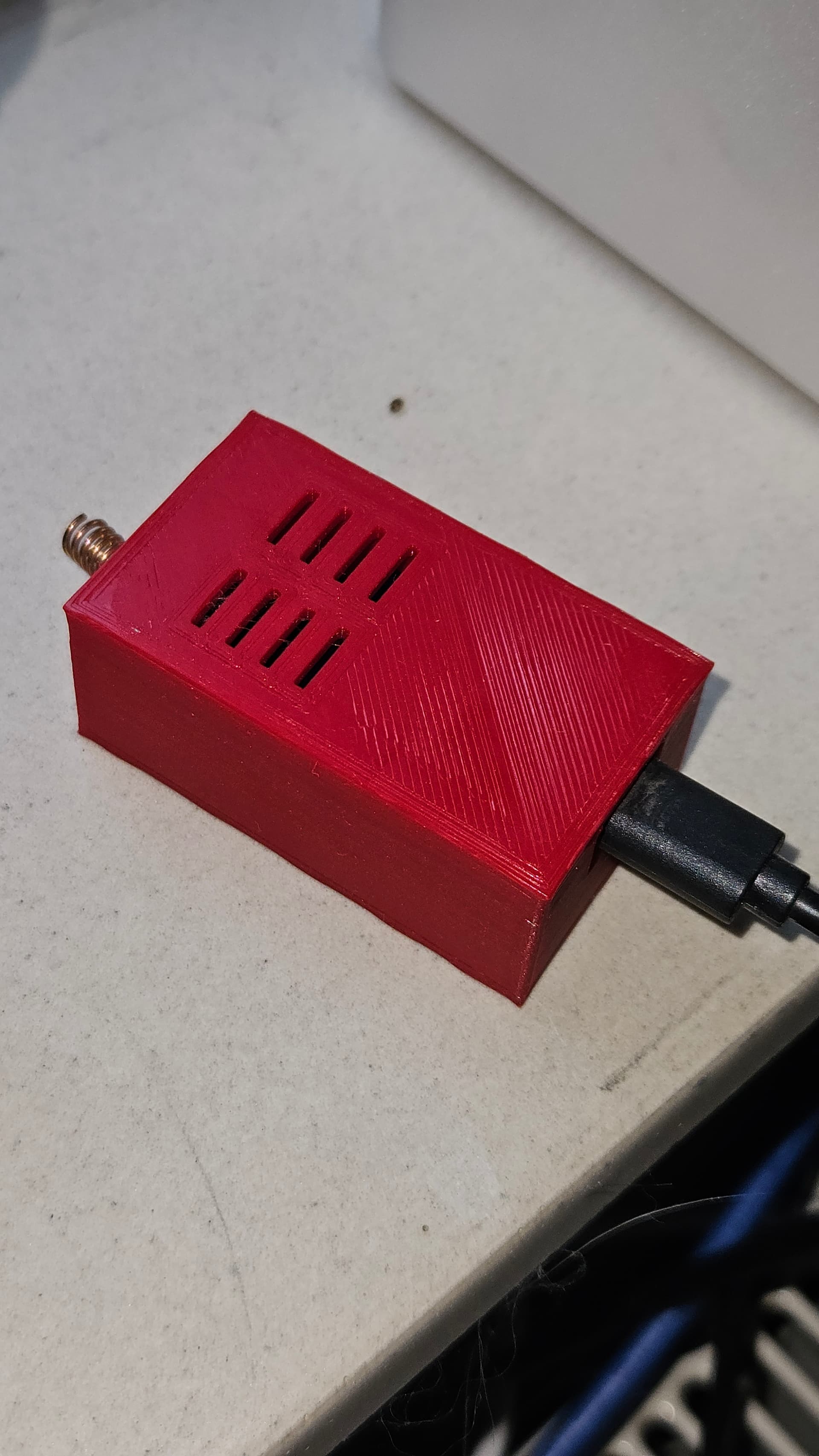

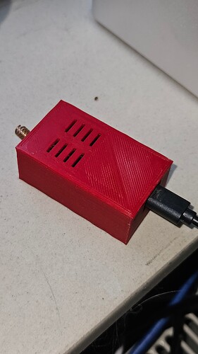

I can solder it for you.
Live in the Netherlands (Ede)
And print a box for it.
