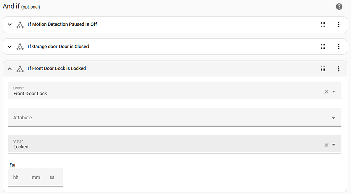

Guide for CCTV Snapshot on motion, send to Google Generative AI & get notification with description & snapshot

Using the entity state - results in a more human readable config
conditions:
  - condition: state
    entity_id: input_boolean.motion_detection_paused
    state: "off"
  - condition: state
    entity_id: cover.garage_door_door
    state: closed
  - condition: state
    entity_id: lock.front_door_lock
    state: locked
actions:
  - metadata: {}
      filename: /config/www/snapshot/{{ trigger.from_state.name }}_1.jpg
      entity_id:
        - camera.driveway_snapshots_clear
    action: camera.snapshot
  - delay:
      hours: 0
      minutes: 0
      seconds: 0
      milliseconds: 500
