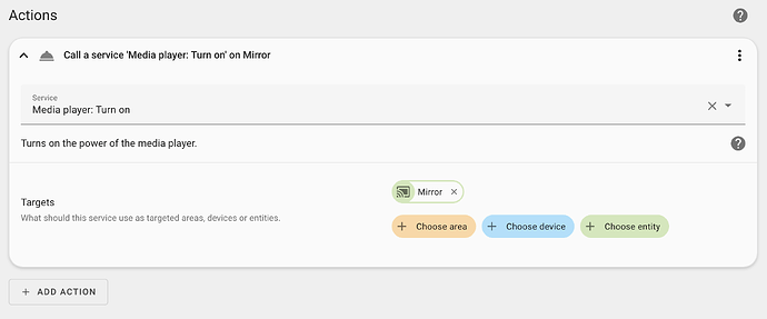

I’m a newbie and are trying to control the status on/off state of the frame but with no luck.
There are no actions visible of the device object if I try to create an automation.
Pushing the on/off switch of the card works ok so the integration is obviously up and running.
Any hints on how to proceed would be much appreciated!
Hi, and thanks! The Meural is set up as a media player, and will respond to the usual service calls for a media player. So using service calls media_player.turn_on or media_player.turn_off on the Meural entity should work:
Thx, its working.
For a newbie the object model isn’t obvious when you could switch things on and off and when you need a service to perform the action.
Anyway you always learn something.

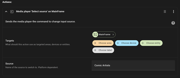

I have been unable to change albums via automation. The attached sshot shows what I am doing. Two of the albums are titled “Christmas” and “Comic Artists”. I had it set to change from Christmas, back to Comic Artists on Jan 5th @ 8AM, however, it did nothing. So I manually ran the action and watched. The image on the Meural blinked to black for a half second and then went right back to the image it had. Album remained unchanged.
I figured, ok, maybe it doesn’t support spaces in the album name. So I changed in the automation to load “Halloween” and the same thing happened.
Am I doing something wrong?
There’s definitely a bug in there; I just tested on my own device and it fails for some playlists as well. However, I can successfully select some playlists with a space in them, so that’s not a specific part of the bug.
If you go the detailed view of the meural canvas media player, and you click on the Source dropdown, do you see the playlists you are trying to change to? Are you using their names exactly as shown in that list, including capitalization, symbols and spaces?
I’ve also added this to the issues on github to keep track of:
Think I fixed it with v1.1.2, give it a try?
Sorry, I’ve been working. Absolutely fixed! I just manually ran both actions and they worked great. You are beyond awesome :slight_smile:
