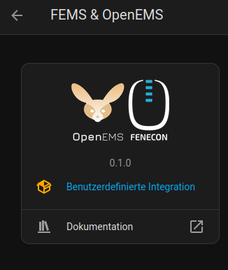

Thanks for the fix! I have noticed though that the version number displayed in Home Assistant is still 0.1.0 like shown in my screenshot, not a big deal though. But maybe it has something to do with the Updates only showing up in HACS and not in the normal Home Assistant Settings?
Thanks for the hint.
Looks like I also need to change manifest.json#L13
Next times, I will try to make sure to keep it aligned.
