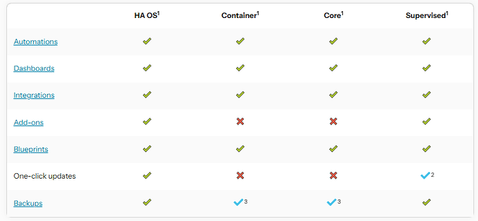

Go into Settings → System → Repairs - than click the three-button menu on the top right, select “System Information” to see what you are running.
“Home Assistant Supervised” is a certain kind of installation. HAOS - “Home Assistant Operating System” - includes the “Supervisor” as well.
See this link for more details as well on some of the different kinds of installs available, and scroll down to note the table:
