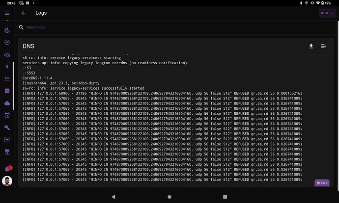

Well so far it definitely stopped my PTR requests. Just two HINFO IN … REFUSED now, not sure what that means.
Well a few more than two. I don’t run pi hole or anything. Unify UDM is my router.

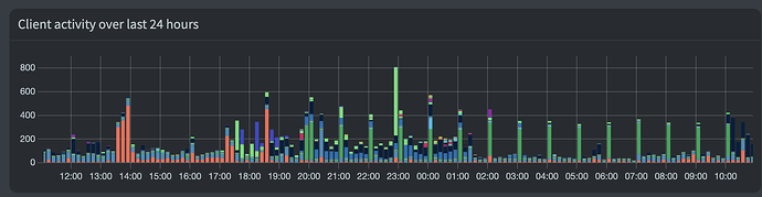

It starts around 20:00 when I installed the new version, and then the hourly spikes:

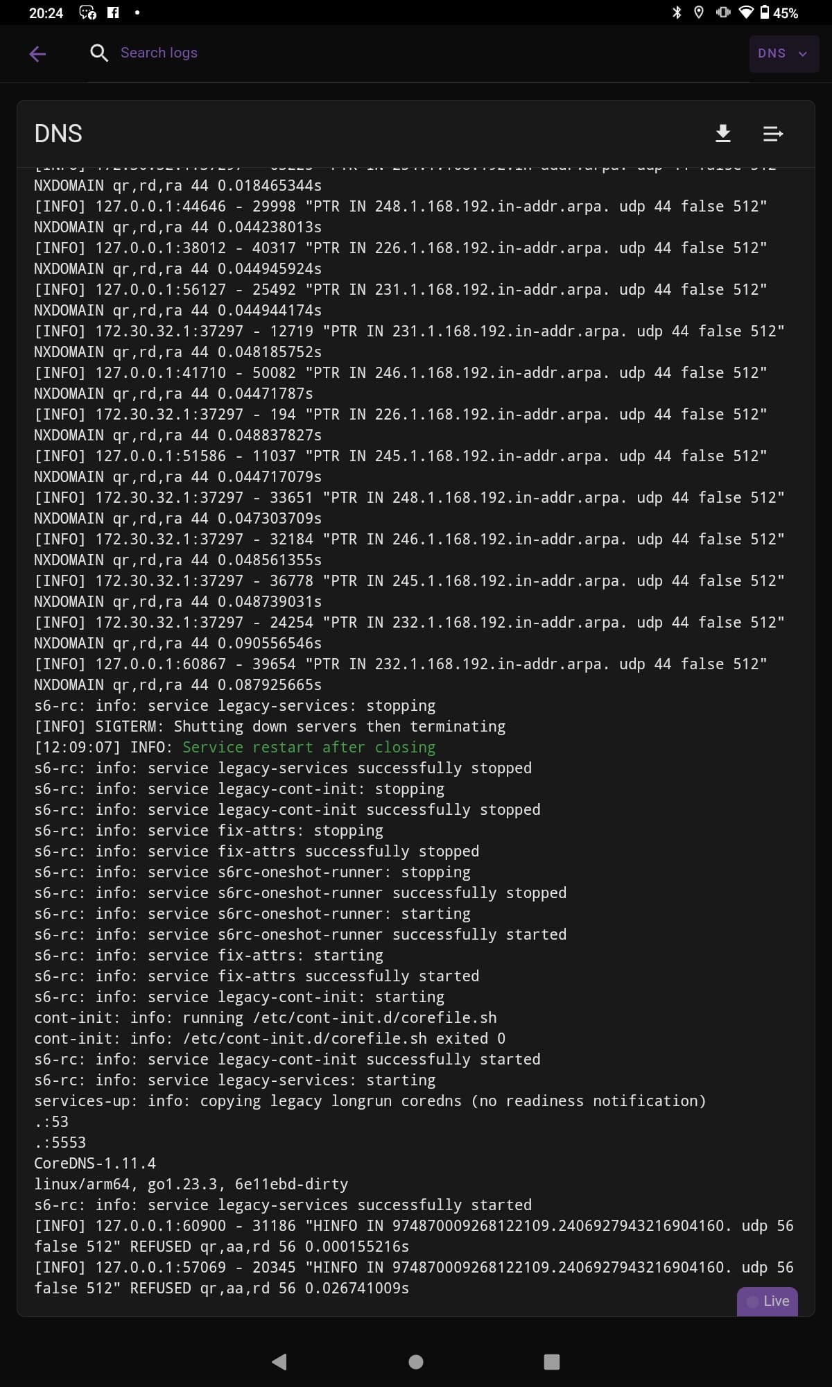

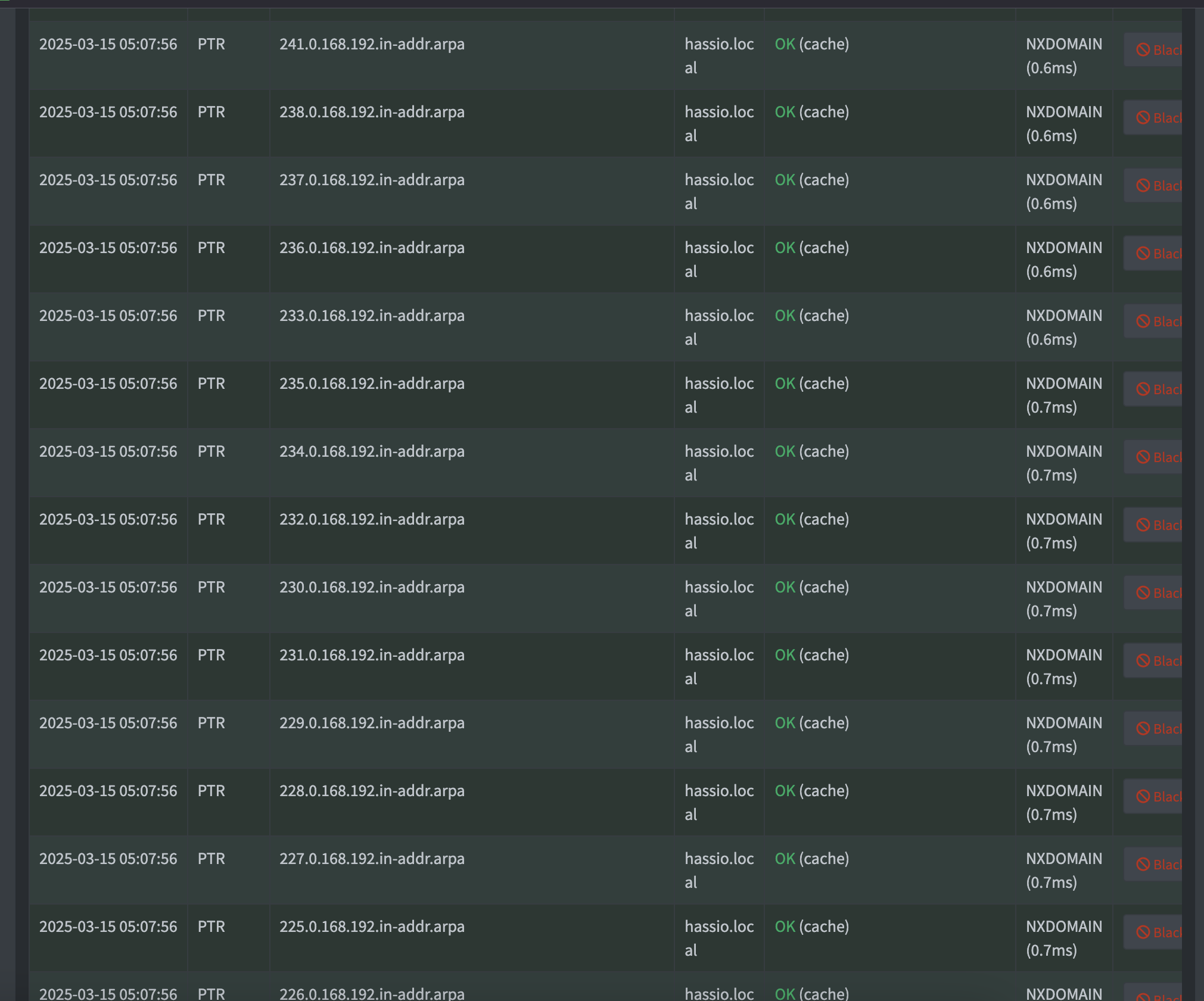

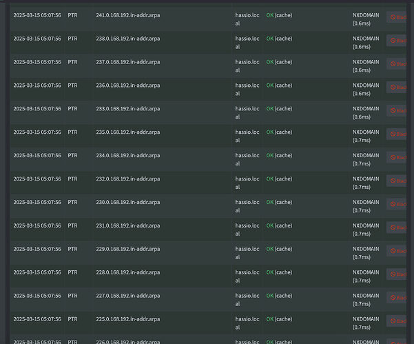

And the requests:
Yep, same here. Never had this issue before, suddenly started after updating to 2025.3
And another one here - I’ve never seen this before 2025.3. Since then I’ve been logging around 260-270 PTR queries every hour from HA, looking at IPs on my LAN. A few hours ago I used the Default Config Disabler to disable the DHCP integration, as suggested further up the thread, and that seems to have stopped the queries - so far so good.
