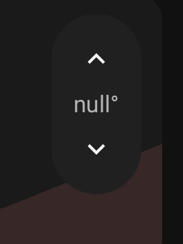

I’m having an issue with the graph showing up for the climate card:
The second card is using the mini-graph-card while the top is the HaCasa implementation.
This is my yaml for this card:
- type: custom:button-card
  template: hc_climate_card
  entity: climate.ecobee_thermostat
  show_window_state: true
  show_mode_state: true
  show_graph: true
  graph_entity: sensor.ecobee_thermostat_current_temperature
  graph_color: var(--color-red)
Does anyone have any insight on this?
Its not formatted correctly
variables:
  show_grah: true
hc_climate_card:
  variables:
    show_graph: true
    graph_entity:
    current_state_label: "Current state: "
  show_label: true
  show_state: true
  tap_action:
    action: more-info
  state_display: |
      return variables.current_state_label + states[entity.entity_id].attributes.hvac_action;
  label: |
    [[[ return states[entity.entity_id].attributes.current_temperature + '<sup style="font-size: 40px;">°</sup>' ]]]
  show_icon: false
  styles:
    grid:
      - grid-template-areas: |
          'l buttons'
          'n buttons'
          's buttons'
          'footer footer'
          'graph graph'
      - grid-template-rows: repeat(5, min-content)
    card:
      - padding: 15px
    name:
      - justify-self: start
      - align-self: end
      - font-weight: 600
      - font-size: 14px
      - z-index: 2
      - margin-bottom: -7px
      - pointer-events: none
    label:
      - font-size: 70px
      - align-self: start
      - font-weight: 700
      - z-index: 2
    state:
      - color: var(--subtext-color)
      - font-size: 12px
      - margin-top: 4px
      - font-weight: 500
      - z-index: 2
    custom_fields:
      graph:
        - display: |
            [[[ return variables.show_graph && variables.graph_entity ? 'block' : 'none' ]]]
        - position: absolute
        - left: 0
        - bottom: -1px
        - width: 100%
        - z-index: 1
      footer:
        - margin-top: 10px
        - display: flex
        - justify-content: center
  custom_fields:
    buttons:
      card:
        styles:
          grid:
                'item_1'
                'item_2'
                'item_3'
            - row-gap: 1.20
          card:
            - padding: 10px
            - border-radius: 50px
            - box-shadow: none
            - background-color: var(--button-card-background)
            - z-index: 3
          custom_fields:
            item_2:
              - opacity: 0.7
        custom_fields:
          item_1:
            card:
              icon: mdi:chevron-up
              styles: &icon_style
                icon:
                  - width: 25px
                card:
                  - padding: 10px
                  - border-radius: 500px
                  - box-shadow: none
                  - background: none
              tap_action:
                action: call-service
                service: climate.set_temperature
                  temperature: |
                    [[[ return states[entity.entity_id].attributes.temperature + 0.5 ]]]
                  entity_id: "[[[ return entity.entity_id ]]]"
              show: |
                [[[ return states[entity.entity_id].attributes.hvac_mode === 'heat' ]]]
          item_2: "[[[ return states[entity.entity_id].attributes.temperature + '°' ]]]"
          item_3:
            card:
              icon: mdi:chevron-down
              styles: *icon_style
              tap_action:
                  temperature: |
                    [[[ return states[entity.entity_id].attributes.temperature - 0.5 ]]]
              show: |
    footer:
      card:
        type: horizontal-stack
        cards: |
            const modes = states[entity.entity_id].attributes.hvac_modes || ['off', 'heat', 'cool', 'heat_cool', 'dry', 'fan_only'];
            return modes.map(mode => ({
              type: 'custom:button-card',
              icon: `mdi:${
                mode === 'off' ? 'power' :
                mode === 'heat' ? 'fire' :
                mode === 'cool' ? 'snowflake' :
                mode === 'heat_cool' ? 'autorenew' :
                mode === 'dry' ? 'water-off' :
                mode === 'fan_only' ? 'fan' : 'help-circle'
              show_name: false,
              styles: {
                card: [
                  { 'margin-right': '10px' },
                  { 'border-radius': '50%' },
                  { 'box-shadow': 'none' },
                icon: [
                  { width: '25px' },
                  { color: states[entity.entity_id].state === mode ? 'var(--accent-color, #FF9500)' : 'var(--primary-text-color)' },
              tap_action: {
                action: 'call-service',
                service: 'climate.set_hvac_mode',
                data: { hvac_mode: mode },
                target: { entity_id: entity.entity_id },
    graph:
      card:
        type: custom:mini-graph-card
        entities:
          - entity: "[[[ return variables.graph_entity ]]]"
            show_fill: true
            show_line: false
        show:
          icon: false
          state: false
          points: false
          labels: false
        height: 100
        line_width: 2
        line_color: "[[[ return variables.graph_color ]]]"
        card_mod:
          style: |
            ha-card {
              background: none;
              box-shadow: none;
              --ha-card-border-width: 0;
              z-index: 1;
        tap_action:
          action: more-info

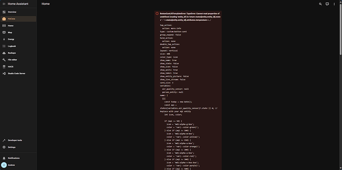

Hello everyone!
I’m trying out this project to refresh my dashboard, which is built on Matt8707’s Lovelace. I’m currently adapting some cards. This template is for the climate system, where I’ve automatically added the operating modes to the footer and the device status in place of the repeated temperature value. If you like it, feel free to use it.
A Note for the Creators
Please review the installation proposed on the website, as there are some unnecessary configurations:
a) If the settings to hide the header have been moved to the theme, there’s no need to propose them and overlap them with Kiosk.
b) Configuring in storage mode (config.yaml - see the second photo) does not require manually declaring additional resources. These will be loaded automatically by the system if uploaded via HACS or manually in settings -> dashboards -> resources.
c) In the main.yaml file, folders should be indicated as shown in the third photo.
I recently discovered this dashboard, and the documentation appears excellent. However, after adding the details to the config.yaml file and rebooting, while it seems to run fine, I am presented with an extensive message.
All additional HACS components have been included.
Any advice?
If you scroll all the way down to the bottom of the error it does say ‘Welcome Home, what are you upto’ as mentioned within the docs
Here is my Config.yaml
Loads default set of integrations. Do not remove.
default_config:
Load frontend themes from the themes folder
frontend:
themes: !include_dir_merge_named themes
automation: !include automations.yaml
script: !include scripts.yaml
scene: !include scenes.yaml
http:
use_x_forwarded_for: true
trusted_proxies:
- 192.168.1.119
homeassistant:
packages: !include_dir_named packages
#rest: !include rests.yaml
input_boolean:
use_openai_next_driveway:
name: Use OpenAI Next (Driveway)
initial: true
use_openai_next_patio:
name: Use OpenAI Next (Patio)
initial: true
##HaCasa
lovelace:
mode: “storage”
resources:
  • url: “/hacsfiles/button-card/button-card.js”
    type: “module”
  • url: “/hacsfiles/my-cards/my-cards.js”
    type: “module”
  • url: “/hacsfiles/kiosk-mode/kiosk-mode.js”
    type: module
  • url: “/hacsfiles/lovelace-card-mod/card-mod.js”
    type: module
  • url: “/hacsfiles/mini-graph-card/mini-graph-card-bundle.js”
    type: module
  • url: “/hacsfiles/lovelace-layout-card/layout-card.js”
    type: module
  • url: “https://fonts.googleapis.com/css2?family=Montserrat:wght@100;200;300;400;500;600;700;800;900

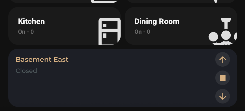

I made a cover card hope people can test it and let me know what they think
Example card
template: hc_cover_card
entity: cover.living_room_blinds
variables:
  dark_mode: false
  enabled_modes:
    - up
    - stop
    - down
Switch between dark and light mode and add\remove buttons in enabled modes section
Since the modes are dynamic you can add your own in the code template and then adjust it to fit with all sorts of entities. I also made a simple speaker card that shows volume controls if the device is on.

Hi @NovaG, this is a great addition!
Been pouring everything I have into this project, I’m in love with it!
Between my own understanding and some AI assistance, my dashboard is coming together!
I noticed your cover card is not quite the same background as my other cards when in Dark mode.
Where in the template can I reference the same color?
Hi @pajeronda, I had set up your version of this card, but as you can see, on the right side, when my thermostat is Off, I see “Null”
I noticed in your screenshot, your thermostat is off, but it still displays a temperature.
I copied/pasted your template code. Have you made a change since the screenshot that fixes this?
Check the temperature value for your thermostat in the dev tools → state
