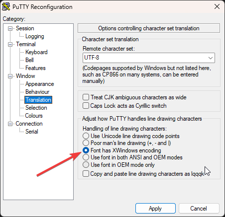

I guess we assumed you were on a windows machine.
Linux have so many other terminals that comes with a standard installation that Putty rarely gets used on those OSes.
