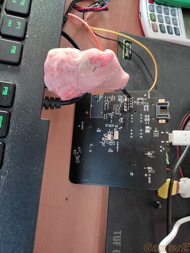

i am stuck… i have solder the wire and can get a usb connection but i get garbage in it
i try to send key but nothing is happening even do the soldering is present…
thx in advance for your help :slight_smile:
so nuts… i had plug my device to a routeur usb3 then a power suply same garbage then i tried my usb3 from pc and all fine…
for those having issue with the esc input…i have just pin the wire directly on the test node (gold one above the hole) and it went through.
first time soldering and it was not a great success but at least achieved to hack my 2 gateway so: job done!
thank you so much for the contributor that made it happen.
cheers! :beers: :beers: :beers:

so you will see a small gold point above the soldering one. you can try to make it rock and roll as my try and it should goes through :smiley:
