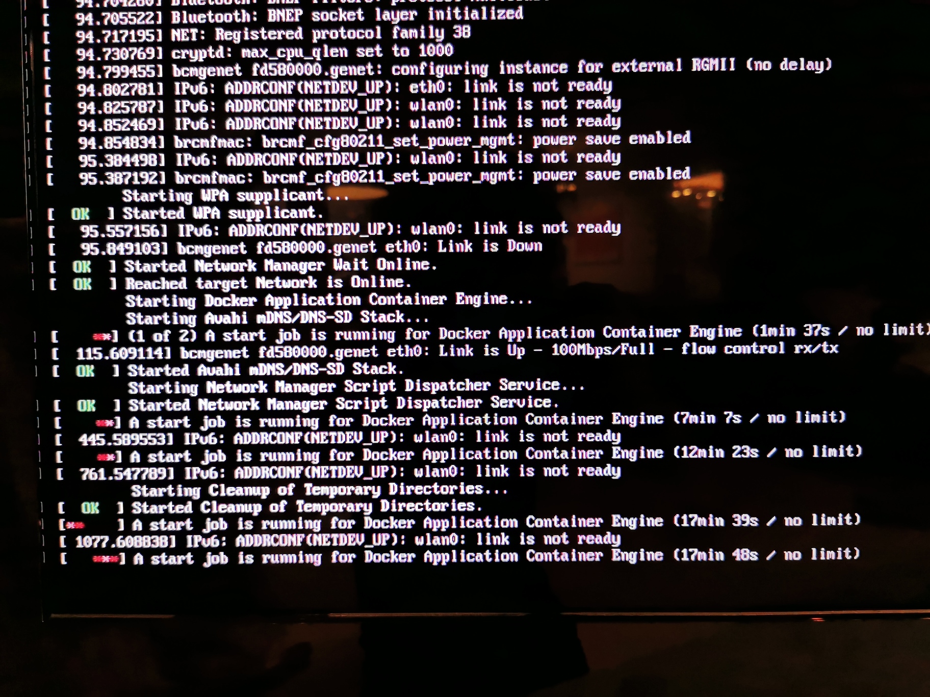

Just want to pile on here. Exactly the same problem. I did a fresh install of HassOS a couple mouths ago and this suddenly happened. The only container that got started after reboot was the observer container and nothing else. I could manually start up all the other container but ssh still doesn’t work. After starting the the homeassistant container, I can get to the ui but cannot get to the supervisor to do backup/snapshot. I am fairly familiar with linux and docker and I couldn’t find anything wrong. Before I reinstall, can anyone point me to things that I can check. I don’t find any log files that show any obvious error. Because ssh doesn’t work, I cannot cut and paste easily into here. My version is 4.12 from /etc/os-release.
I got quite a few of those “A start job is running for …” message but eventually, it said “OK” for started the Docker Application Container Engine

In my case i got /etc/docker/key.json file corrupted after upgrade from 5.10 to 5.13. Strange, but fact.
(I have RaspberryPi 4 installation with USB SSD)
How I found it:
  1. Boot from SD made like discribed here (Raspberry Pi - Home Assistant) - if you have Linux installation or VM with linux you can skip this point & connect SD/SSD from Pi to your computer.
  2. Mount /dev/sda8 (ha-data partition mounted in /mnt/data on regular runs) to some temporary folder like /tmp/a8
  3. Open journal to find problem by running "journalctl -D /tmp/a8/logs —since ‘1 hour ago’ | more» - as i told before my problem was in corrupted file
  4. Replace broken file from fresh SD card - in my case needed file was on device /dev/sda7 (/etc/docker), so i mounted it to /tmp/a7 and so on

Been trying for two days now, and booting a new VM + recovery was either not working or taking too long (more than 3 hours).
I was almost ready to give up and try to recover older backups.
When booting in recovery mode, move or rename the docker .db file:
(in my case I was browsing and it was under /mnt/data/docker/… I think)
sudo mv /var/lib/docker/network/files/local-kv.db /opt/old-docker-local-kv.db
