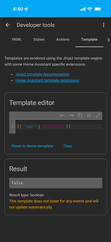

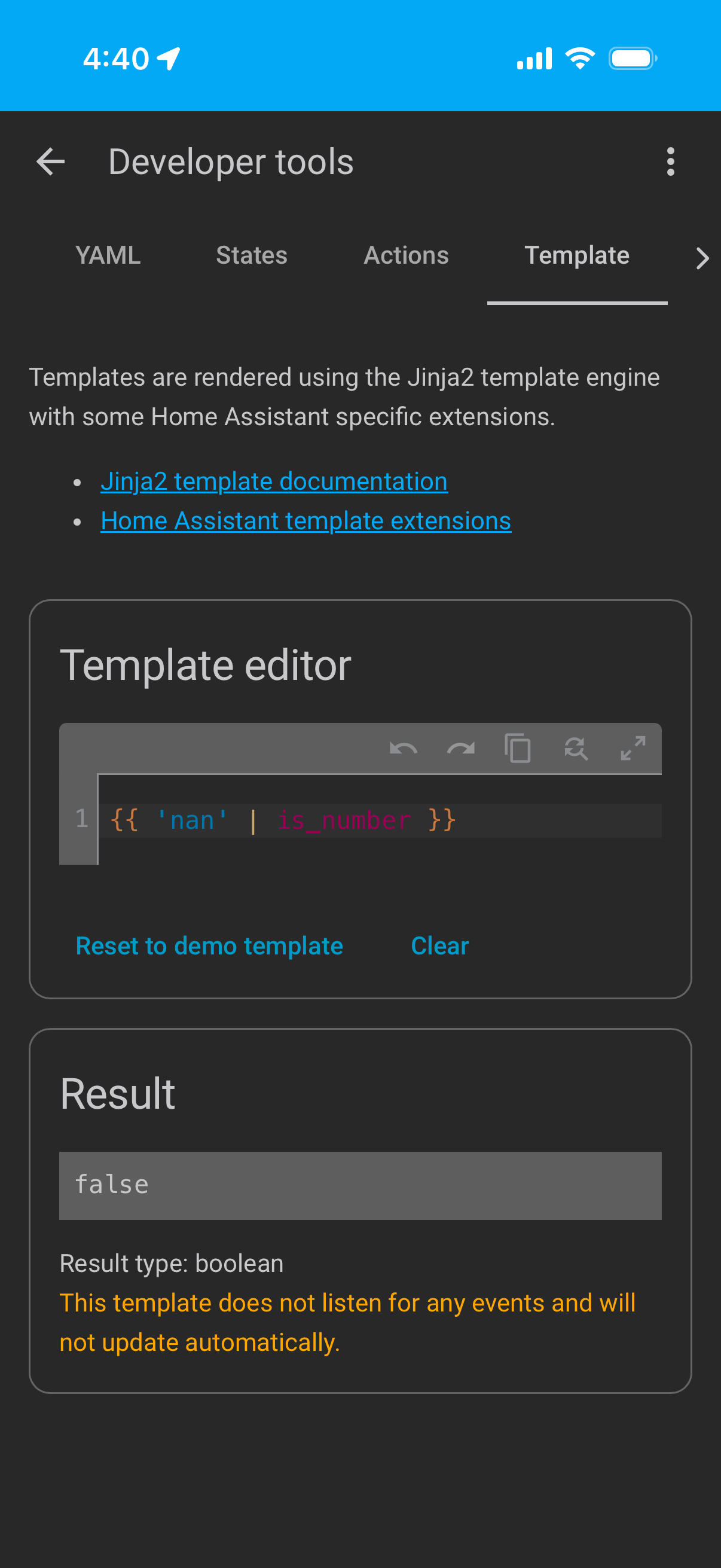

I did not mention those constructs because they still produce False with is_number. The only one that produces true with is_number is np.NaN. Try it yourself. Takes 2 seconds:
{{ float('nan') | is_number }}
{{ float('inf') | is_number }}

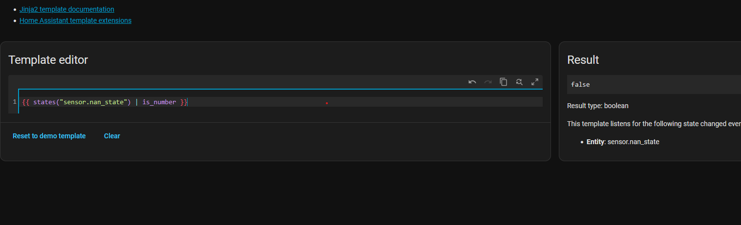

Thanks for making my point as you are correct that this is False:
But my point is that the following would be True:
template:
  - sensor:
      - name: "nan_state"
        unique_id: nan_state
        state: >
            {{ float('nan') }}
{{ states("sensor.nan_state") | is_number }}

No it would not, because the state comes from the state machine.
Try it yourself. Very simple test.
EDIT: exact proof that you’re just making things up.
results in a ZeroDivisionError in python, will not occur anywhere.
Possible, but also not possible because there’s no way to get inf in HA at this moment aside from you manually using it in Jinja to do this.
Will result in a ValueError unless using numpy.
No such function in HA. The jinja macro uses statistics.fmean which will result in a StatisticsError with an empty list.
Can we please move on now? All you’re doing is adding incorrect information to this thread.
