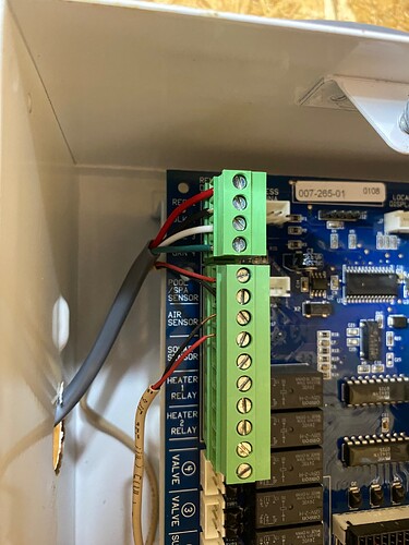

@J4yDubs , @Sierra I finally received my EW11A and I’m trying to hook it up properly however I am not able to see the EW11 SSID. I’ve followed the setup page (AQL-PS-8 & EW11 Setup Instructions - Google Docs) and reversed my configuration to make sure I was wiring things in the right order. Here’s my current setup:
It seems like my EW11A is receiving power because the green ethernet LED is on.
Am I missing anything?
False alarm, @J4yDubs & @Sierra , turns out it wasn’t wired properly… Here’s the correct way of wiring it for future DIYers :stuck_out_tongue:

I can confirm that the script was uploaded properly, however I cannot connect through it from HA or Mark’s app. :frowning:
Try switching the white and black wires on the EW11 (it’s the two TX/RX lines).
