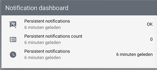

talking about that Dashboard yaml:
type: entities
title: Notification dashboard
show_header_toggle: false
state_color: true
card_mod:
  class: class-header-margin
entities:
  - entity: binary_sensor.persistent_notifications
    secondary_info: last-changed
  - entity: sensor.persistent_notifications_count
    format: relative
  - type: custom:hui-element
    card_type: conditional
    conditions:
        state: 'on'
    card:
      card_type: markdown
      card_mod:
        style: |
          ha-card {
            box-shadow: none;
            margin: 0px -16px;
      content: >
        {% set count = states('sensor.persistent_notifications_count') %}
        ### {{count}} Notification{{'' if count == '1' else 's'}}:
        {% for m in state_attr('sensor.persistent_notifications','notifications') if m %}
        **{{m.title}}**{{'\n'}}
        *{{m.message}}*{{'\n'}}
        {{m.id}}{{'\n'}}
        {% endfor %}
  - type: conditional
    conditions:
        state: 'on'
    row:
      entity: script.dismiss_all_persistent_notifications #script.dismiss_all #former python
      secondary_info: last-triggered
      action_name: Wis
I could drop the bottom 2 conditional in 1 and use an entities card + plus a nice divider, but then I’d have to mod that again to not show borders/shadows etc. this was the lazy solution.
here’s the other:
    conditions:
        state: 'on'
    card:
      type: entities
      card_mod:
        style: |
          ha-card {
            box-shadow: none;
            margin: 0px -16px;
      entities:
        - type: divider
          card_type: markdown
          card_mod:
            style: |
              ha-card {
                box-shadow: none;
                margin: 0px -16px;
          content: >
            {{m.id}}{{'\n'}}
            {% endfor %}
        - entity: script.dismiss_all_persistent_notifications #script.dismiss_all #former python
          action_name: Wis
couldn’t resist and it seems less condition checking for the Frontend, so maybe just a bit more efficient
