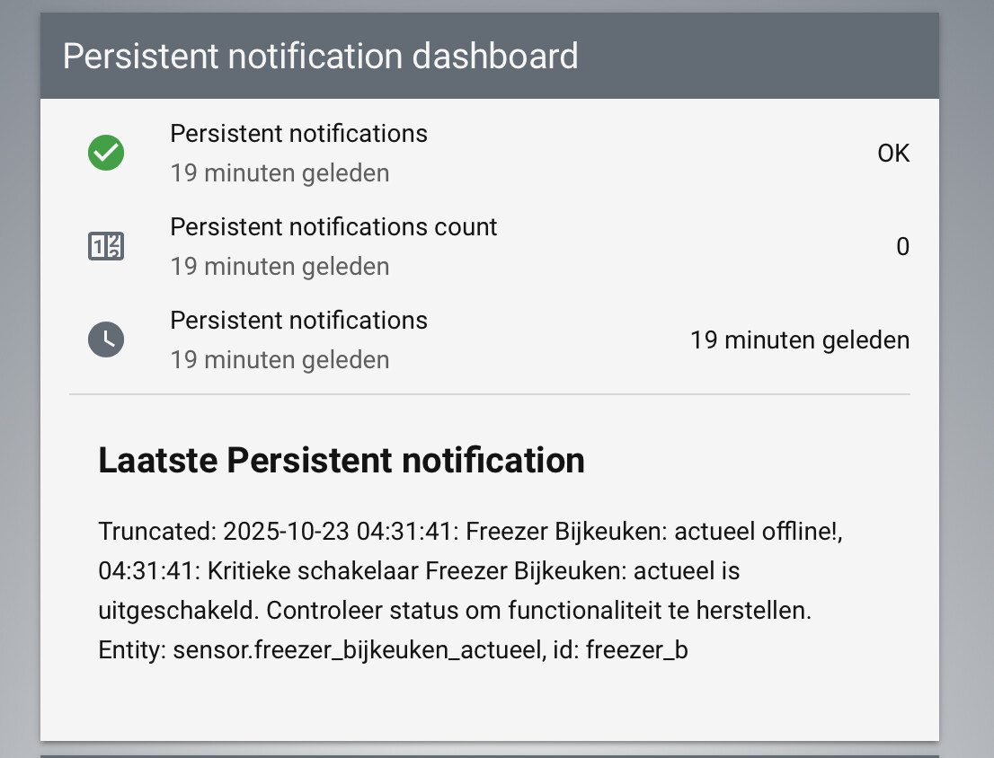

I ended up making a custom component that counts the number of active persistent notifications, and also those who start with a specific string in the id.
you can try it out yourself:
This is what todo lists are for, all built into HA. Well, for the tasks at least.
I know they are,
But I needed the functionality of the component for my doorbell images anyway. When finished, I realised I could use it also for the cat-tasks. That way, I can declutter my dashboard.

you something like this?
or with an active pers not.
notifier when count is not 0
its all in there, no additional resource required at all, just the template and some frontend conditions
see Heads up: 2023.6 longer has persistent notifications in states: what to do? - #91 by Mariusthvdb (has it been more than 2 years already…?) for the yaml
