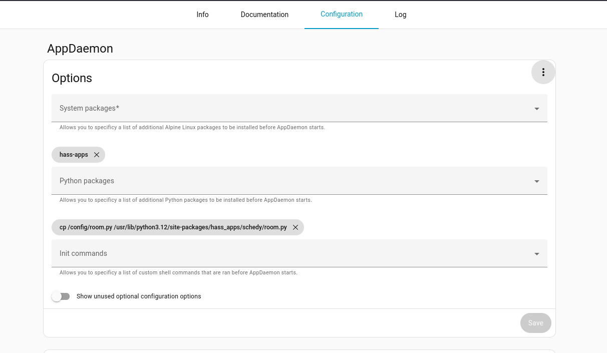

The easiest solution I came up with is:
1/ put a copy of the patched room.py in a directory that is mounted in the container. In my case, it’s in the addon_configs/a0d7b954_appdaemon/ which is mounted in /config in the container
2/ launch appdameon with an init command that copies the patched room.py in the right place. In my case: cp /config/room.py
/usr/lib/python3.12/site-packages/hass_apps/schedy/room.py
Screenshot of the configuration page of appdaemon:

Thank you very much, this sounds like a straight forward solution which I want to try since the latest AppDeamon update did not fix it. Just one problem, where o find the full room.py file which I need to patch. I was expecting at github but cannot find it.
Just realized I can reverse the command to get the file initially :slight_smile:
Everything is working again, thanks for the support!
