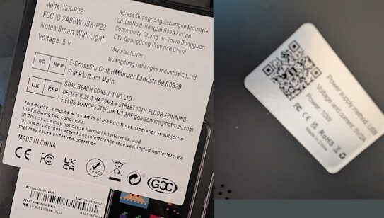

Thanks for sharing @padiddlyboing but unfortunately doesn’t work for my sign which was purchased from Kmart in Australia. Perhaps there’s something different about the setup? What’s the specs of your sign?
@JJW.AU this is the spec of my display: -
Rather strangely, whilst mine was working, I’m now seeing the same sleep(0.01) error! Will have another play.

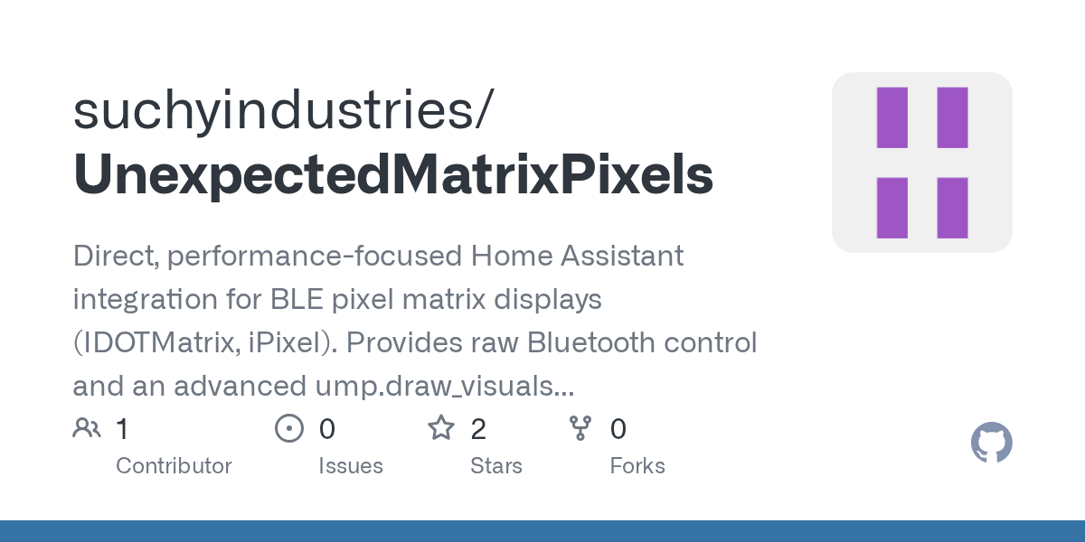

Try this, help develop
@suchy_cow This is BRILLIANT! THANK YOU!
Works well on my Kmart display with some very basic testing. Will try more tomorrow as I have three displays and was having issues controlling all three with the other code. Would love to be able to extract the animated pictures from the idotmatrix app and load them via Home Assistant
Thanks! I’m currently trying to get it to work.
How do you get it to pair with HA? I’m not seeing it show up anywhere and can’t find any way for the device to enter pairing mode? Or is there a different way to get the MAC address of the device?
Thanks!!
@evorgevol - From memory I think I used a bluetooth sniffer tool on my mobile phone to scan for MAC addresses. There’s no need for pairing mode using this new integration. I am finding that I think if the other integration has connected with the device then it locks the communication. You then need to power cycle the device to release it. Same happens if you use the idotmatrix app.

This was perfect, thank you! I used nRF Connect app on my phone to find the device and just entered the MAC address from it. I’ve currently only tried text and icons, but both appear to be working promptly for me! Thanks @JJW.AU and a massive thanks to @suchy_cow
Thank you @suchy_cow for sharing this
I too have tested it on my K-mart 16x16 iDotMatrix display and it works.
