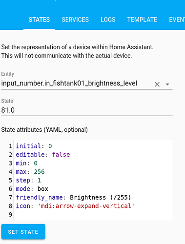

This value doesn’t change:
Screenshot_2020-03-14_18-58-25
Brightness override not working either.

No, it just displays 123, which isn’t the actual value the dimmer is currently at, and changing this through the interface doesn’t change the levels and the value jumps back to 123

UPDATE: The value is not showing 120, so maybe it’s ramping down? It doesn’t look like actual dimmer value is changing however.
Turning on brightness override sets the above value to 255, however it does not change the light level.
It looks like all the functions are working but not sending the values to the dimmer controller

Monitor the number, it ‘should’ basically change every 80 seconds and go to 30 at 22:00 and jump to 0 and stay that way till 12:00 tomorrow jump to 30, ramp up, ramp down, rinse and repeat.
Check you don’t have this light anywhere else in you automations

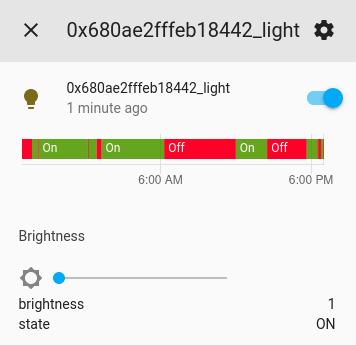

The number is going down, it’s now 97, but it’s not dimming the light.
It does not appear to be sending the value to the dimmer, as neither the decreasing values nor the override have any effect on the dimmer.
Check that the name of the light in the automation is exactly the same as your actual light

Edit : There is a problem with brightnes: vs brightness_pct: (No Idea Why) Please go down to Post 95 for the workaround

@bedfellow so, I don’t actually use brightness, I use brightness_pct and when I cenvert the package to brightness_pct it works (not been through a full day yet though.

Okay, I found a thread with a solution to brightness: using a template by pnbruckner.

It does work for pct so I’ve modified the package for that.
Using 0 = off, 11 = minimum brightness, 100 = maximum, then over 5hrs (18,000 seconds) that’s a step every 202.247 (and some change). So I set the update to 101 (more than twice the required frequency but still a saving on the previous).

I’ll await someone a ‘LOT’ wiser than I (sets the bar pretty low) to explain what’s going on with brightness vs brightness_pct
I’m playing with at Tasmota RGBCT light.
What you have there looks like the second step to me.
From what I have working you need to add two data sections:
  - data:
      brightness_pct: 12
    entity_id: light.0x680ae2fffeb18442_light
    service: light.turn_on
  - data:
      brightness_pct: 100
      transition: 18000
  - data:
       brightness_pct: 12
      transition: 18000
