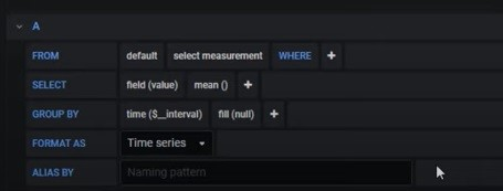

So with influx db2 I dont have to possibilty build my queries inside grafana with this:
Since this Plugin seems to be stale since a few month, i’ll leave a link to my implementation for this influx2 addon on github.
Since yesterday, i also managed to get ingress working. Thanks to @smoki3 for folling up these request :smiley:
That's by design.... influx2 nativly dropped the influxql language..
i'm using the "Data Explorer" from Influx to create my queries and if the work, simply transfer them to grafana....
Otherwise have a look for DBRP for Compatiblity..
I also mentioned these issue in my documentation for my plugin on GitHub - Dattel/homeassistant-influxdb2: Homeassistant Addon for InfluxDB2 · GitHub
If you need v1.x compatiblity for e.g. grafana, you have to create a retention policy for the database and a user for authentification. Replace the @bucket@ with your value.
