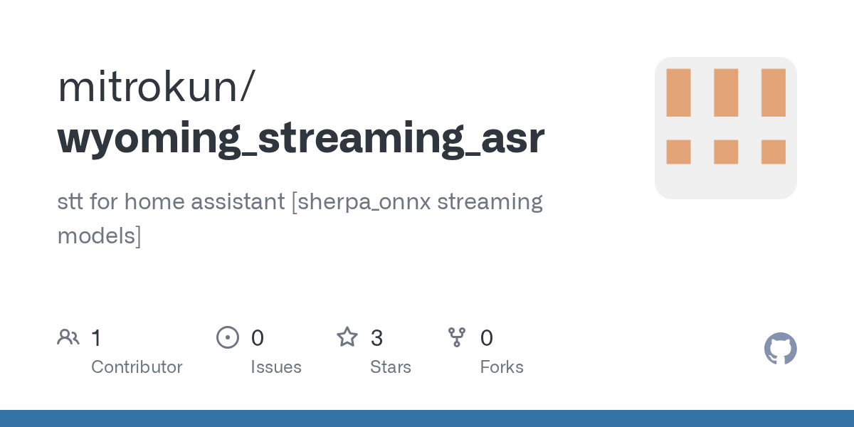

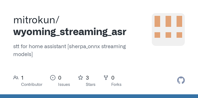

Anyone know if the new Nemotron ASR which released this January will be made available by either of the STT addons ?
but I can’t check the quality of recognition.
Some people think the model isn’t very good, and the offline parakeet v2 model is better. So if OnnxASR works at an acceptable speed, then there’s no need to waste time on it.
If you test it, please share your results.
