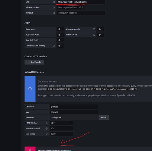

Followed this video by @frenck . I reach the step where I connect Glances database to Grafana.
I keep getting this error.
This is the error in error connecting influxDB influxQL
What am I doing wrong?
Home Assistant 2023.2.4
Supervisor 2023.01.1
Operating System 9.5
Frontend 20230202.0 - latest
Glances Current version: 0.17.2.
Influxdb Current version: 8.1.0
Grafana Current version: 8.1.0
Update: database and info proccessing options were disabled under the addon config.
** working now!!!**
