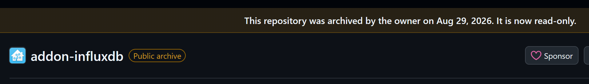

Somehow I missed the communication on that change…
(kinda funny though that 404 ^^)

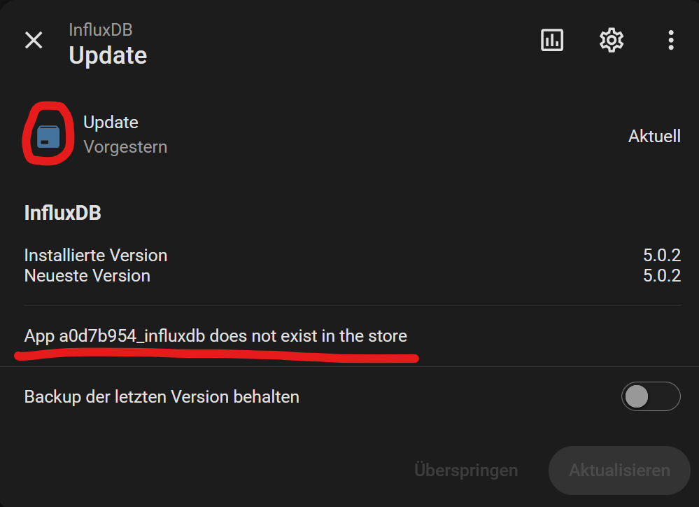

Accidentally stumbled over this as I was wondering why that entity icon is missing…

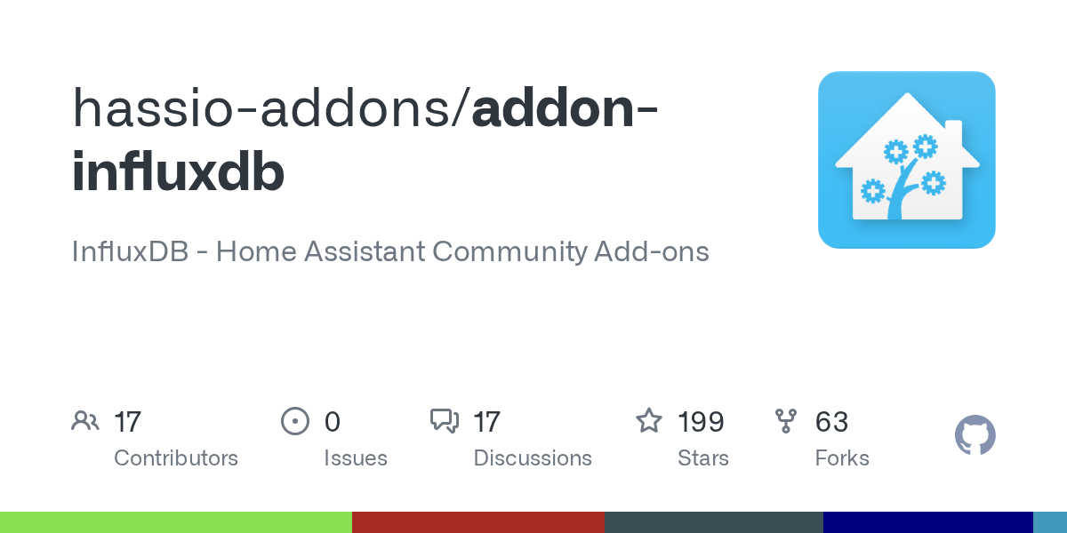

So I guess users have to follow Migrating from InfluxDB v1 to v2 (intermediate difficult level) in Home Assistant Add-on: InfluxDB v2 to upgrade to InfluxDB v2?
As there are at least two InfluxDB v2 addons out there, curious to know which one users should choose…
Curious to see what else will break or be necessary to just “keep everything working”, not even taking benefit from potential v2 advantages. Oh dear, sounds like a tough migration “project” with few GB of InfluxDB size :expressionless_face::expressionless_face::expressionless_face:
