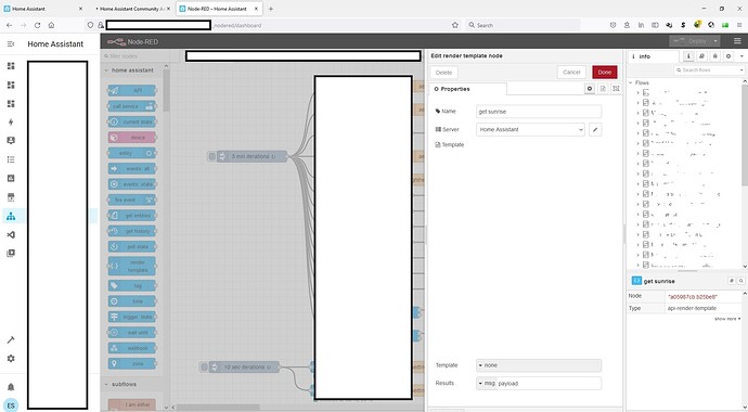

Template field has disappeared from render template node (see picture)
The field was always there up to version 12.0.2. It is gone in version 13
the existing logic still works but the node can no longer be modified or newly introduced (actually it can be dragged in but there is no way to input a template)
