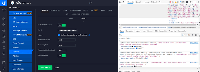

I had the same problem; I activated RADIUS in the new settings menu which resulted that the Client option was unchecked/disabled. I deleted the VPN and disabled RADIUS and reconfigured everything in the ‘old’ settings, but the client option was still disabled and greyed out…
But I was able to enable the client checkbox by using the browser developer tools. I did it with (the new) Edge browser, but it should also work with Firefox, Chrome etc.
- In the Unify controller setting menu go to Services > RADIUS (tab) > Server (sub tab)
- Here you should see you RADIUS configuration with the Client options unchecked and grayed out
- Press F12 to open the browsers developer tools
- Go to the Elements tab and press the element picker (or use Ctrl + Shift + C)
- Click on the (grayed out) Client checkbox
- Remove this text:
disabled class=“ng-pristine ng-untouched ng-valid ng-valid-divergent ng-not-empty”
Change this:
To this (option is now not grayed out anymore and you should be able to check the option now):
