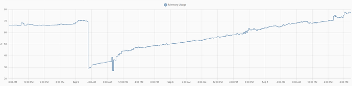

I had been running HA on 32bit and found out unifi controller ver 1 needs 64bit going forward so I have updated my OS to 64bit. Before update I had no issues with Unifi controller or its memory/cpu usage. with upgrading to 64bit Unifi controller add on itself consuming 45% of the memory and its not just right away. After I reboot memory usage starts with 1 or 2 % then gradually increase to 50% sometimes more than 60%. Is there a memory leak issue with unifi add on ver1?
I’m using Rpi 4 with 4GB ram.
