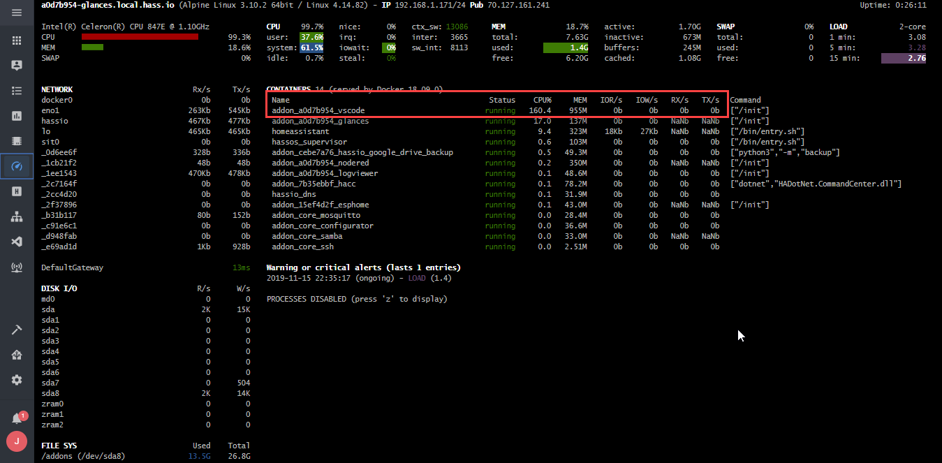

I am, except mine pegs the CPU and will sometimes even lock up my NUC and I have to pull the power.
I’m getting the “Visual Studio Code is unable to watch for file changes in this large workspace” which according to the docs says it can’t be helped, but I wonder if this has something to do with the ridiculously high CPU usage? Unfortunately, I have to keep the add-on turned off as sometimes my Node-RED flows won’t even kick off with it running.
Hopefully, someone has a thought on how to fix this!
