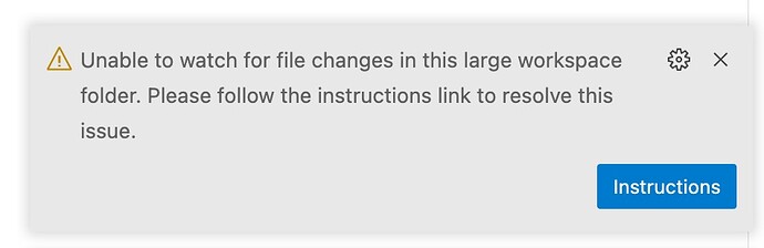

I’ve started to get this error which points me to these instructions but not sure how to fix this with this HA addon:
