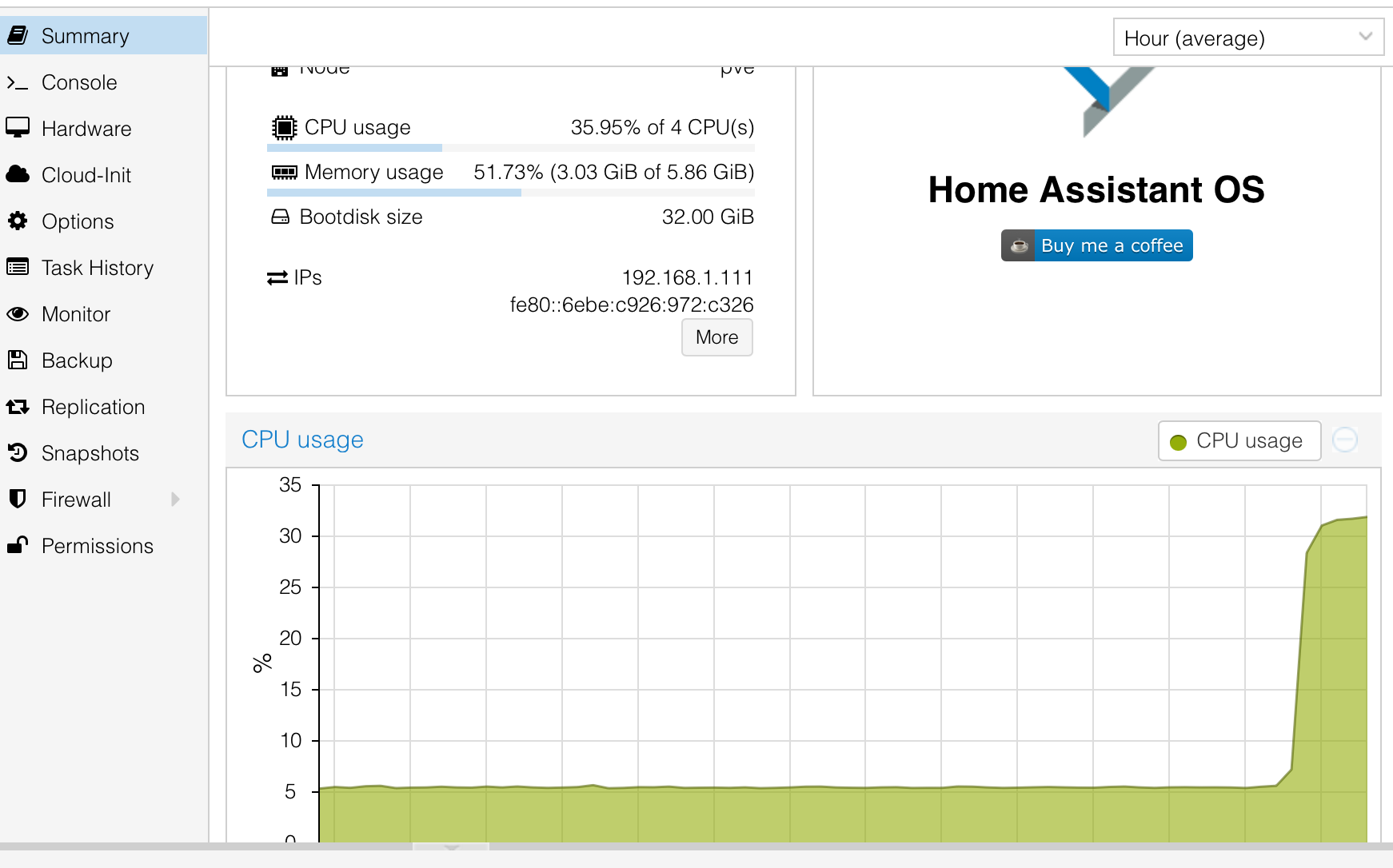

I’m new to HA, bought a Beelink mini pc and installed HA via Proxmox. Of course I enabled the VSCode addon as it’s my favorite code editor.
Well I noticed the fan on the mini pc was making a lot of noise, I would restart and the noise would be back after a couple of minutes.

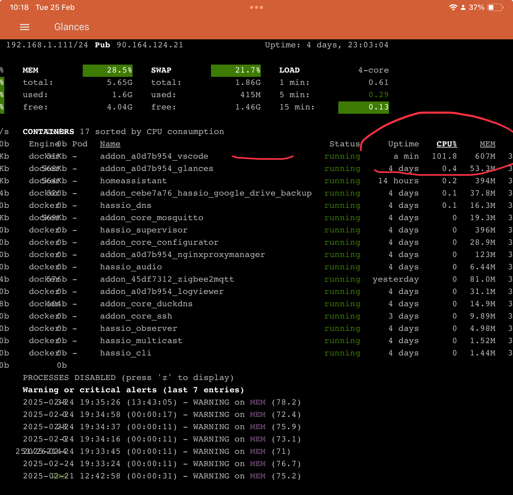

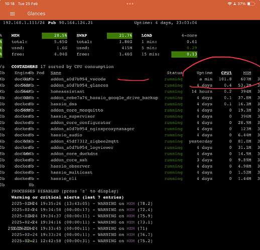

It wasn’t until I read about the “Glances” add-on that I found the reason. VSCode container makes the cpu and memory spike to 100% and just stay there…
Here’s an example of CPU usage when enabling VSCode addon: after stopping VSCode the cpu goes back to 1-2% ( and no more noisy fan).
So now I just enable VSCode on demand or use it via ssh from my laptop. Hope it helps someone. The noisy fan was a real issue, I thought I’d have to quit the whole HA thing.

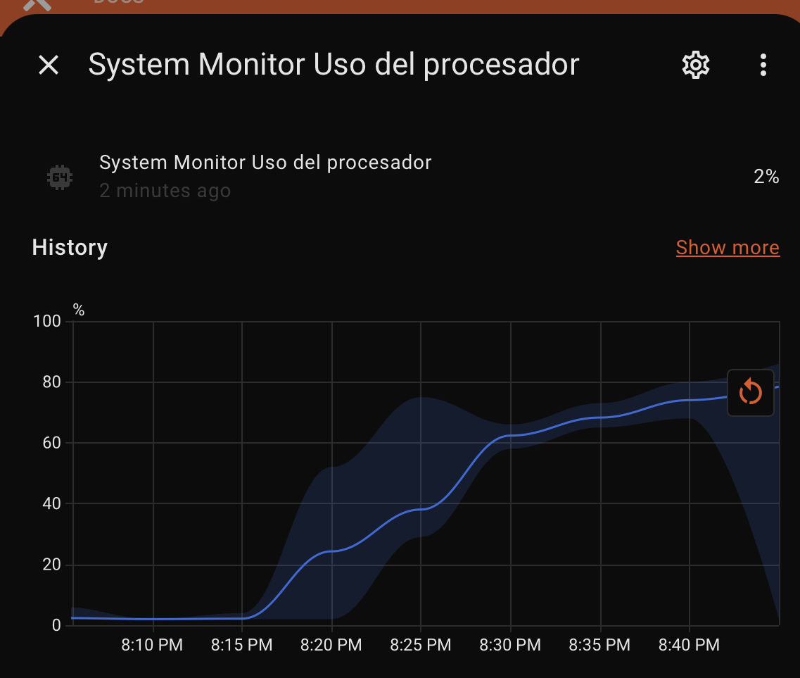

As you can (hopefully) see in the graph, the cpu and memory usage starts rising gradually and over a period of about 5-10 minutes it reaches almost 100%. It doesn’t matter if I’m using VScode or not.
I know I’m not the first one, I looked into vscode cpu usage and installed Glances after reading something similar in this forum somewhere. It was mentioned that it could be related to having root as the default folder for vscode, but I changed it to no avail.
