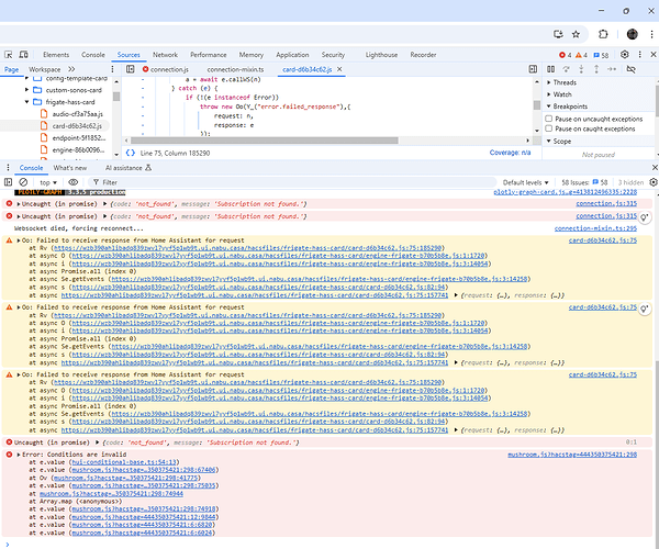

Hi, I keep having problems with the connection getting lost and I also have various error messages in the log. I’m trying to get to the bottom of this and have therefore opened the developer tools in the browser and found various errors. One relates to Browser Mod, which I was able to solve. Now I have several more errors, mostly related to Mushroom. But I still don’t know what the problem could be. Can anyone help me here?
Screenshot 2025-01-26 230126
Now just by chance I could see the connection being reloaded and this error occurred at exactly that moment.

A little update. I’ve now removed a few cards from my dashboard, including Frigate Lovelace and Bring. There are no more errors now and it seems to be running more smoothly. I still have to observe it over a longer period of time. But if problems arise, I would take a look at the whole thing with the developer tools in the browser and look for errors.
Interesting, I’m also using Proxmox on an NUC I got on eBay and rebuilt with a new SSD.
I noticed automations being slow and disconnects from websocket happening at the same time. And then confirmed this often lined up with CPU usage spikes in the Proxmox graphs.
Good to hear you resolved it (at least as it seems). Not being an expert on tracing the problem (e.g. I don’t recognize your mushroom and card.js screenshot), can you point me a bit more into how to use the develop tools? And how to troubleshoot this myself?

I’m not an expert, I can only describe what I did. I opened the Chrome browser, opened the dashboard and then opened the developer tools under additional tools. It then showed me several errors and then I simply removed a few cards and checked whether the errors were gone.
Thanks, that helps. In between the 16 minutes I do not see any errors in the chrome developer tool.

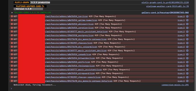

But then again at 16 minutes I get
Not sure if these errors are related as they refer to icons (and not specific code). After websocket restart, all errors disappear. Am I missing something?
