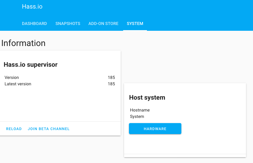

this button is not shown at the Host System part
I see… thats a problem of Hassio at a synology. Maybe can @fredrike help you
thanks anyway
