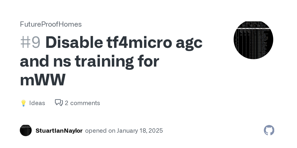

I am training on the Gkws repo with a CRNN because I know it and do what I do of including a falsekw as a honey trap to train against to reduce false positives.
Classification models are just dumb label classifications and unless you provide labels to train and classify against you will get the results they are getting…
I also dunno the level the AGC works on the PE and use vlevel AGC on my machine as often soundcards and microphones are very low but you should try to maximise without clipping audio to get the best end resulting resolution.
You should be able to try with any mic and just run the kws.py script with the model included as its that dataset of hey-jarvis.
As added a final bit on how to make microWakeWord very accurate but its sort of all datasets and the no-brainer is they should be what is the input to the model. This does make custom wake works a lot of work but once done they could be held in a model zoo with some form of peer-review to dodge the dross.
