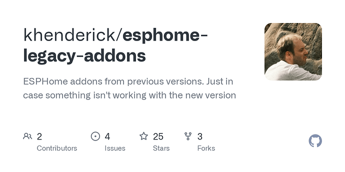

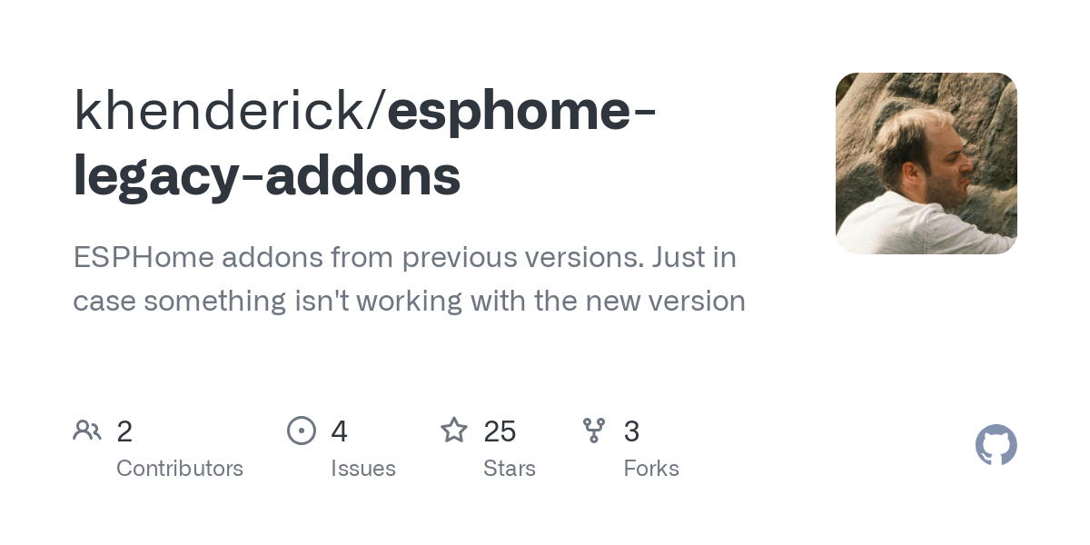

There is no official way to downgrade, unless you created a backup of the add-on at the time when you updated. I hadn’t, so I installed this custom repo into add-ons:
Its an archive of previous ESPHome versions, so I went with 2025.2, as that was the last version I recall it working correctly.
Install this then remove the official release ESPHome add-on. It will automatically find your devices. And no, the add-on is the builder app, same thing.

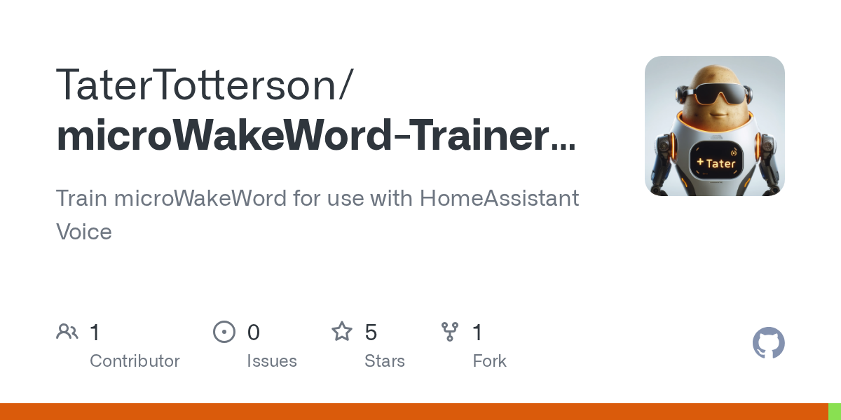

Two and a half months go by and that repo for training microwakeword, and the user, are gone from github.
Yeah seems like the masterphooey docker has been rugged.
You can use this though, looks the same:
