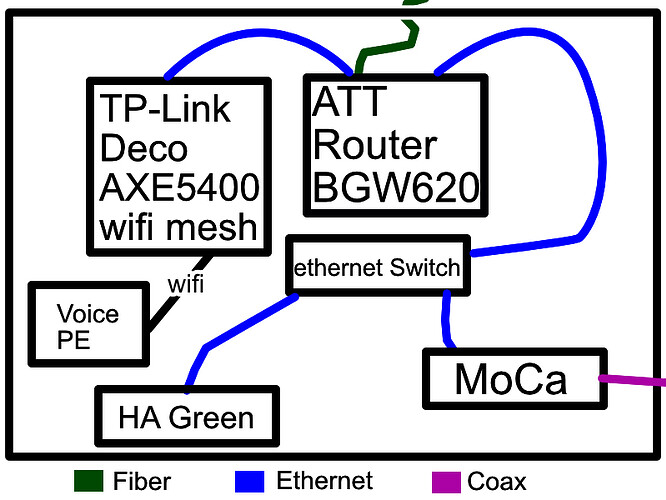

My lovely internet person, I have ZERO clue lol
I bought the Voice PE https://voice-pe.home-assistant.io/
I bought the HA Green https://www.seeedstudio.com/Home-Assistant-Green-p-5792.html
Plugged in HA Green, ran setup no issues
first time Plugged in the Voices, HA asked to add the device, then connect to then net. asked to be added to ESPhome and it was done and working.
Now ESPhome, shows the host* input area, and here i am :sweat_smile:

192.168.68.60 is not on the same network 192.168.1.x
Because the netmask is 255.255.255.0, your network is 192.168.1.1 to 192.168.1.254 (probably the most common in the U.S.)
Curious because you should not have been able to ping 192.168.68.60.
The subnet mask of 255.255.255.0 makes your local network range is from 192.168.1.1 to 192.168.1.254. This means that devices with IP addresses outside of this range, like 192.168.68.60, are typically on a different subnet.
There are a few ways that might explain why you’re able to ping 192.168.68.60 successfully. None of which you may have done.
  1. Routing: Your network could have a route set up that allows communication between different subnets.
  2. Double NAT: If you have two routers (one connected to another), it’s possible that the secondary router creates its own subnet.
  3. Bridged Networks: If there’s a network bridge between the 192.168.1.0 and 192.168.68.0 subnets, devices on both subnets can communicate seamlessly.

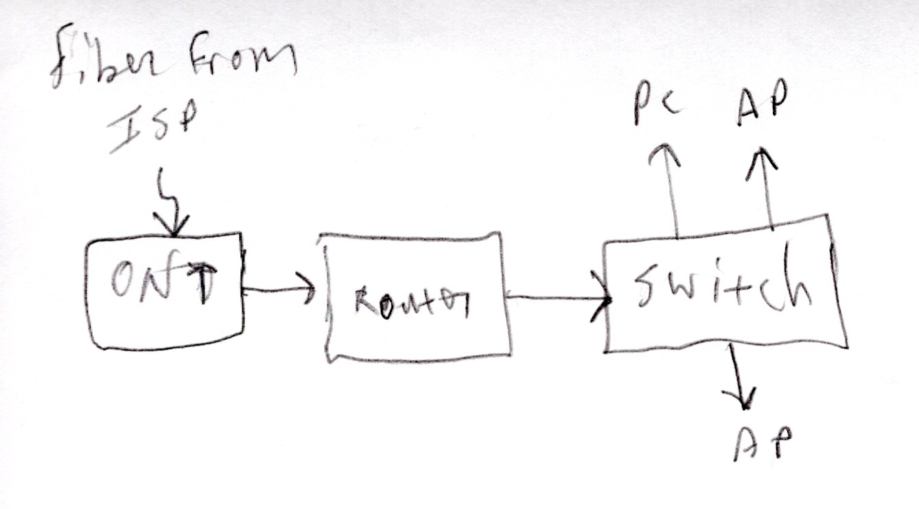

Do you have two routers? This can complicate things considerably.
Ooooh Maybe?!
Fiber wifi was shit in my house so they said I would need a Mesh system for that.
So disable the wifi on the OG router, left that to all the direct plugs and installed the mesh system for wifi
bootlog of mine - showing much the same issue. Possibly it dislikes that my LAN hostnames are in the .lan domain (default for OpenWRT) but it tries to talk to .local (?)
[just to make sure: flat network in the same /24, no VLAN or anything]

Draw a picture of your network. This is basically mine- greatly simplified.
The fiber from the ISP goes into the ONT (Optical Network Terminal). Your ISP may call it something else, but it’s the box that the fiber plugs into. The output of the ONT is your WAN (Wide Area Network). The ONT is all you need from the ISP. You can provide everything else. The Ethernet cable from the ONT plugs into the WAN port of the router. The ISP provided 4-in-one router does four things. (none of them very well in my experience). It provides IP addresses to the clients, routes data between the WAN and the client, usually has a four-port Ethernet switch, and always a WiFi access point. In my system I have one router (a TP-Lnk Omada ER-7206 router), six switches to minimize cable pulls since you can plug a switch into a switch. Two of those switches are POE to provide internet and power to four Wireless Access Points scattered around the house.
If you have two routers, then this could be the source of your problem.
I don’t see anything in your log that is trying to use the domain. Just IP addresses.
But a simple, flat network is where a user should start. Add a subnet or VPN only as you grow into a more complex network.
please hold for drawing lol

I have 2 routers. I own my equipment. Imo, since I just went through this exact issue, that is most likely source of the problem.
Briefly, what fixed my problem was by adding a route in the main router to allow the Voice PE device (in the second router) to communicate with the main network where HA is installed.
This is probably beyond the understanding of routers by most users. But keep watching as this may be the easiest fix for the OP. I want to see the layout of his network to suggest a way to simplify things.
Agreed. Should have also edited my post…I’m not on fiber (I wish!) so my cable network will look different.
Connect your switch to the tp-link and you have everything on one network. It’s rarely beneficial to run two routers in a home network.
When I connected my switch to the TP-link all the ethernet devices (espically the Moca) dropped speed. ATT said it was cause the BGW620, is wifi 7 and my TPlink is only 6… idk if thats true or not
