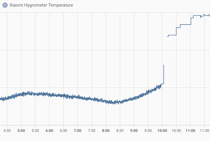

Guys, I integrated mine yesterday via BTHome and it showed up in HA. Things is noticed:
It reported values quite often, about every 10 seconds (didn’t change any settings in the flasher).
Well this morning I moved the thermometer to a different place (where it lost connection) and now its seams pretty reasonable without any changes in the settings. I can imagine that with this jitter it always thinks its a significant change and spits out the new value
Is there a way to reduce thesensitivity?

Try changing the flashing settings as I suggest above. That will reduce the frequency of logging, most people don’t need it logging that often and it takes up disk space. I also find that if the sensor is further from the Bluetooth receiver, some packets are lost and you get fewer readings, but it’s probably still transmitting often and using power.

I changed the values according to the settings above and now the jiitter has gone.

You were also right with the distance, putting it farther away from the recveiver reduced the number of readings. Putting it closer it immediately showed the jitter again.
