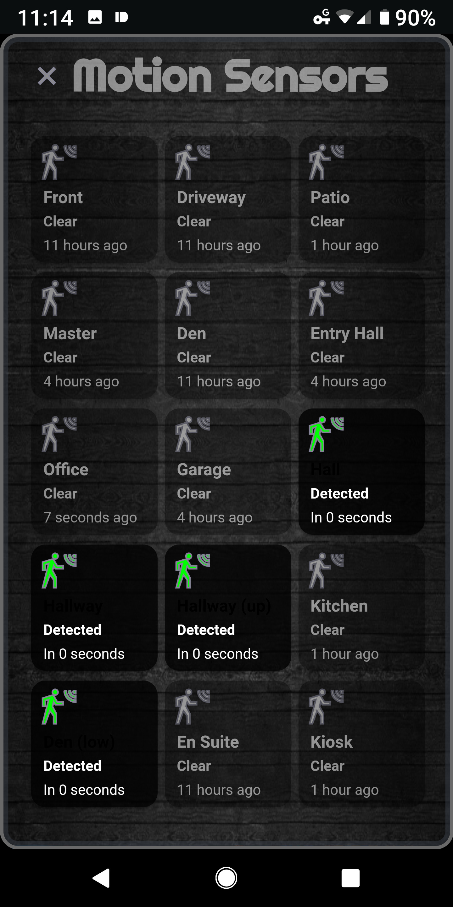

Awesome stuff!!! Thanks for the hard work! @jimz011 I have had the card installed since it was first released, but I have never used custom:button-card . After seeing how nice they display, I borrowed some of your code, tweaked and added the buttons to one of my custom:pop-up cards.
…and I shrunk the code down using @RomRider 's custom:decluttering-card Each button is only 5 lines!!!
            - type: custom:decluttering-card
              template: motion_button_temp
              variables:
                - entity: binary_sensor.front_motion
                - name: Front
Thank you!
