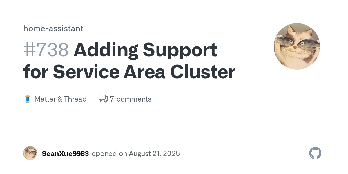

In my latest iOS 26, Home allows me to connect a Roborock Qrevo vacuum via Matter, and the Home UI has an extra popup to select both Floor (it automatically lists the 4 floors I have with their correct names) and then rooms within each floor (here the rooms are unfortunately not correctly named…). At least compared to Home Assistant (where Floors are not listed for the same vacuum integrated via Matter) this is a step ahead.
same. is there any way to get the rooms into home assistant? its wild to me that i had a 4 year old vacuum with granular control, and now i updated to a space age vacuum that i can barely control
You can vote here:
